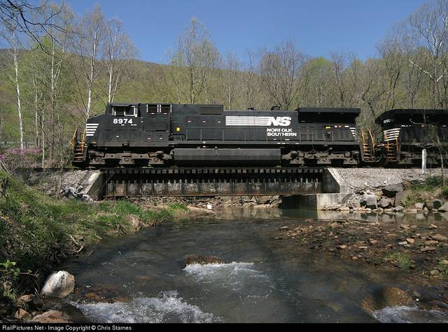

Sorry to drag up an old post, but searching about for prototype pics of bridges, I came across several that looked like they had no bridge shoes. Are bridge shoes mandatory for all bridges, or do shorter spans sometime not have them? Pic below…don’t think this span has bridge shoes, is that right?
As was mentioned 'way up at the top, short girder bridges may not have fancy shoes. They just rest on a steel plate, usually about the same thickness as the girder flange.
Chuck (modeling Central Japan in September, 1964 - with LOTS of girder bridges)
Chuck, thanks…guess the pic is evidence of that…steel plate = piece of styrene in HO…how convenient! [;)]
