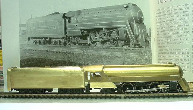

Here is how I did it on a B&O S-1:
There is a full build article available in the NTrak Steam Handbook and also can be seen at BORHS.org under the B&O Modeler magazine.

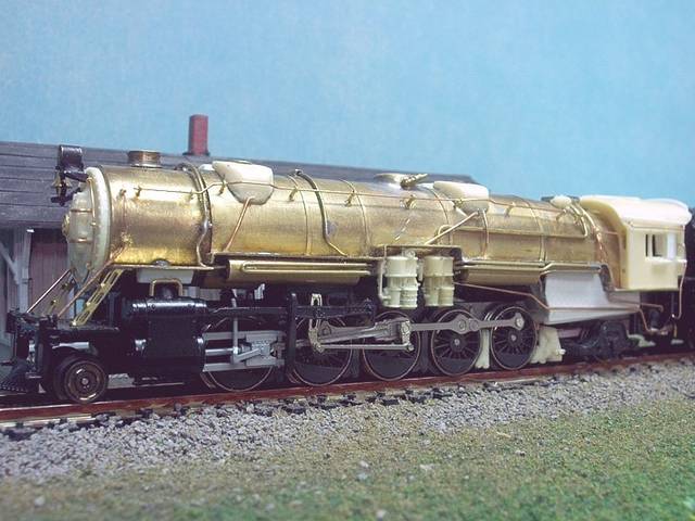

I am currently working on a P7d and an EM-1 among other things. I have construction drawings of an EL-3 to eventually convert a Y-3 but it is a little farther down the list.
Here is a shot of the P7d in process:
The crosshead slide is scratch built and so will the eccentric gear when I get around to it.
Plastic is easier to work with, brass just seems to traslate the look and feel of heavy metal objects better. Plastic seems to end up with softer edges. Learn to use casting resin because it will save you a lot of headache in the long run dupicating parts. Instead of chasing down the ever dwindling supply of pewter detail parts, I make a cast from existing loco’s and make copies for myself when ever needed. Most of the detail parts on the S-1 are castings from a Kato Mikado.

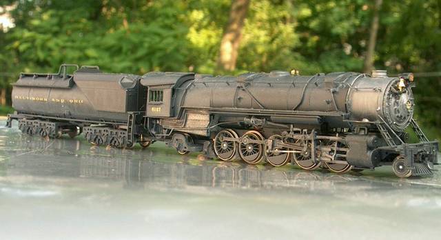

Necroing my own thread. Thanks for the reply skipgear, it was your article in the B&O Modeler that gave me the final nudge to actually try this. The boiler for my first EL is basically complete, now the process of mounting the individual engines is next. Its been a 6 month build so far…hopefully the end result will be worth it.
