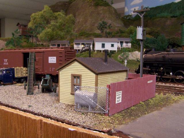

I also use toille, but get the stuff on a roll:
Loks like this after a shot of silver paint and a little rusting:
Noticed I put the posts on the wrong side, tho.[:$]
Terry
