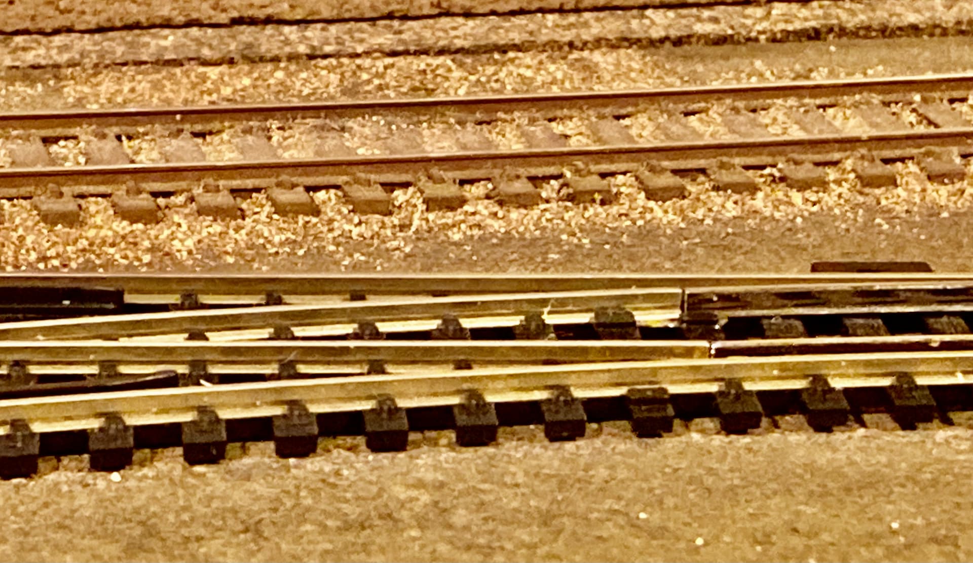

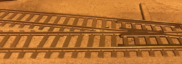

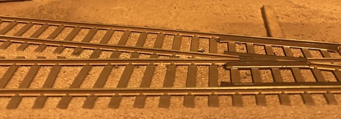

It’s probably too late by now, but before you glue that track down you really ought to paint it. There’s hundreds of videos about how to do it by all kinds of people with “retentive” personalities who paint every tie differently with a brush, but I have to say that my age I don’t have enough years left on earth to use that kind of time up on something you don’t even look at much when the train is running.
I found that spray painting track with a nice flat. Brown really does the job for me. After you get that basic coat on, you can go back and color individual ties if you want, but I’ve been perfectly happy with just the spray coat. It really makes the height of the rail less obvious and goes a long way towards realism. About the only thing you have to be careful about is wiping top of the rail clean after you paint it, and masking off the half inch or so of track around switch points and touch it up with a brush so spray paint doesn’t get all down in there it and mess operation up. Ask me, I know, I did that wrong and I’m still suffering.
Here is some Kato Unitrak with just one light dusting of flat brown, the plastic frogs and ties and even made the grey plastic ballast pretty acceptable to me.
Here are some unpainted and painted code 100 atlas snap track. Look at the difference!

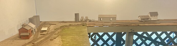

We have a second house over in Mississippi, where I don’t have room inside for a layout. It has to be in a covered outdoor airspace under the house. There are many environmental limitations because of this, and that coupled with the projected two or three year lifespan of this layout means it’s going conceptually be something like yours.
Roving night critters jump up on the layout all the time during the night and patrol. Therefore, I can’t leave out any rolling stock or any kind of structures that have any kind of value. So the most scenery I’m going to have is going to be cheap plastic structures, painted plywood surface with ground foam glued down, and loose lichen placed around. It’s not so bad because I presumably am replicating the Gulf Coast Prairie, where my family lived for so many years.

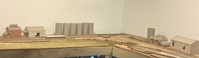

Here’s a scene that more or less represents about all I can do down there. Some of the ground foam is down already, some not. The lichen is just laying loose. If one of God‘s creatures decides to have lunch with it, I’ll just replace it.
Here’s two views of where the two 2x8 sections meet:

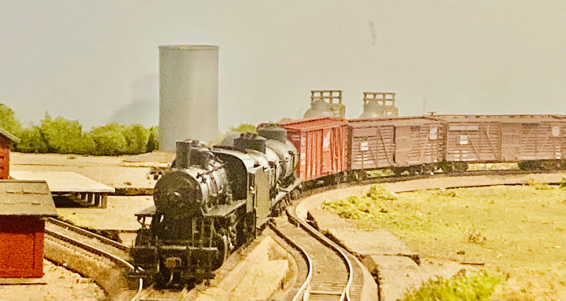

It is not known to very many that the Rock Island ran all the way down almost to the Gulf in Louisiana. Therefore, I run Rock Island stuff from time to time on this layout.
Everything is very simple on this layout. The four vertical oil tanks are cookie cans that were cut in half and painted gray. No big loss if some raccoon or feral cat decides to knock them across the space.
