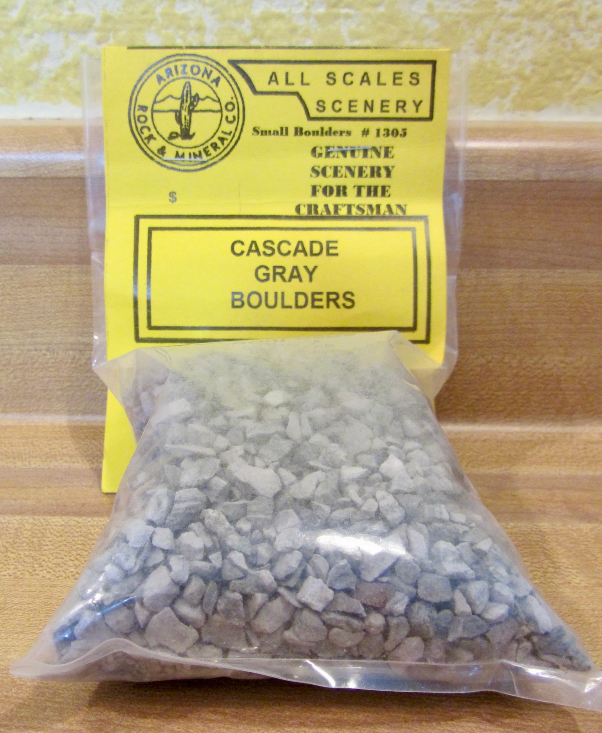

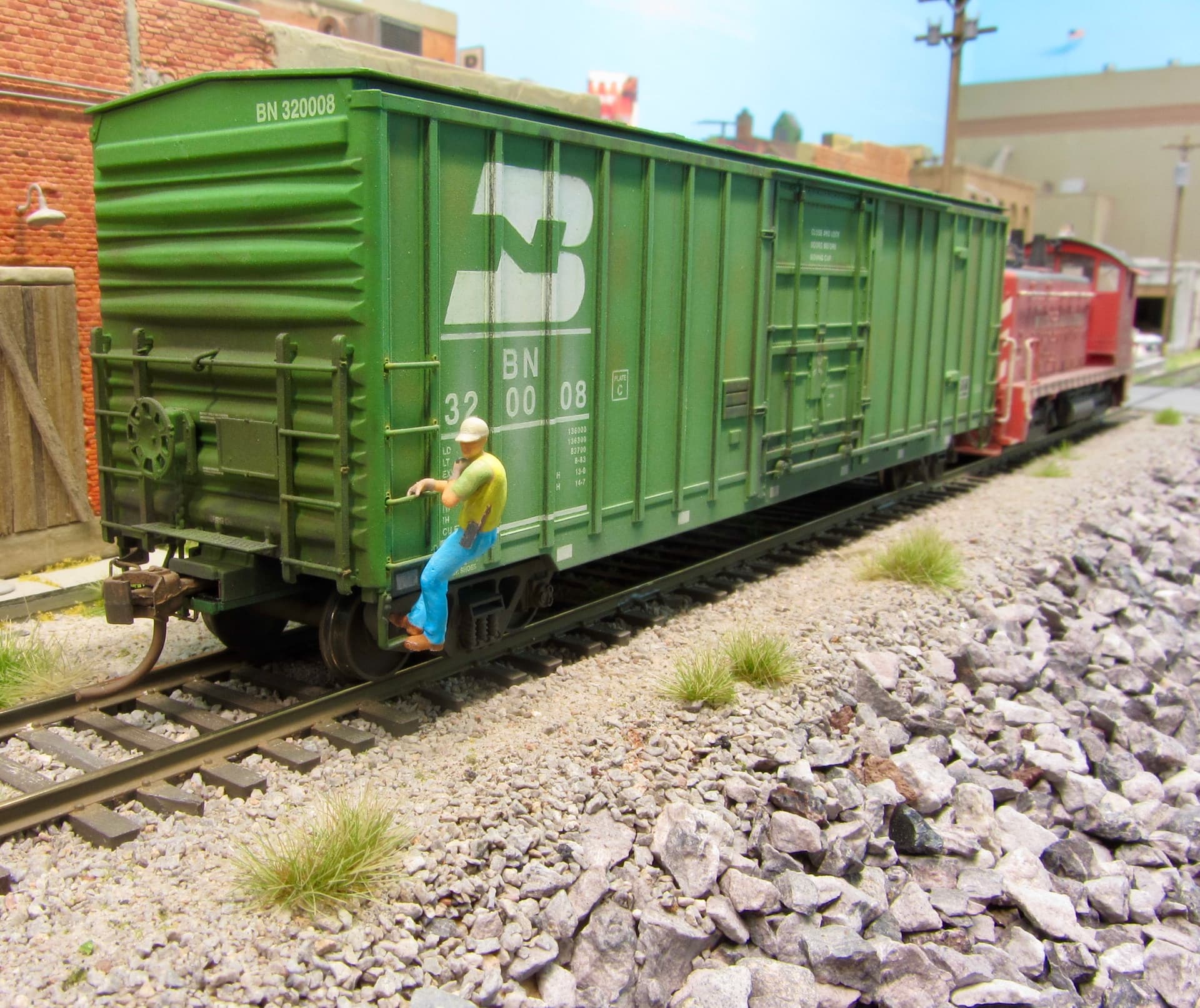

Maybe not what you’re looking for, but used Arizona Rock & Mineral rock products to resemble shoreline rip-rap. Regards, Peter

Do you remember what size you used? Also, is there any rule of thumb to calculate how much to buy? They have a bag that is 12 oz and another that is 7 lbs. I am planning a quarry scene and this looks better than the WS talus.

Been some years. one 9.5 oz bag wasn’t quite enough to cover the 24x1.5 inch area.
Peter

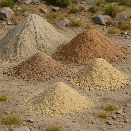

Thanks for the suggestions guys. I like the bag of scale rocks pictured. Will look into those to find out if those are still around or something similar is available.
Making the “cone” bases for the rock shouldn’t be too tough. Then, for some of the rock, I plan on going to our local retail supplier of landscape rock and getting a 5 gal. bucket of their smallest crushed rock (gravel) and then running it through some screen material to filter it down to the sizes I want. That will likely give me way more than l’ll need but having some leftover bags of different sized rocks will come in handy down the line.
I have been using real dirt and gravel, rocks etc. I will start with a sculpted piece of foam then cover with white glue and apply my covering.

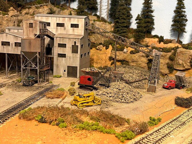

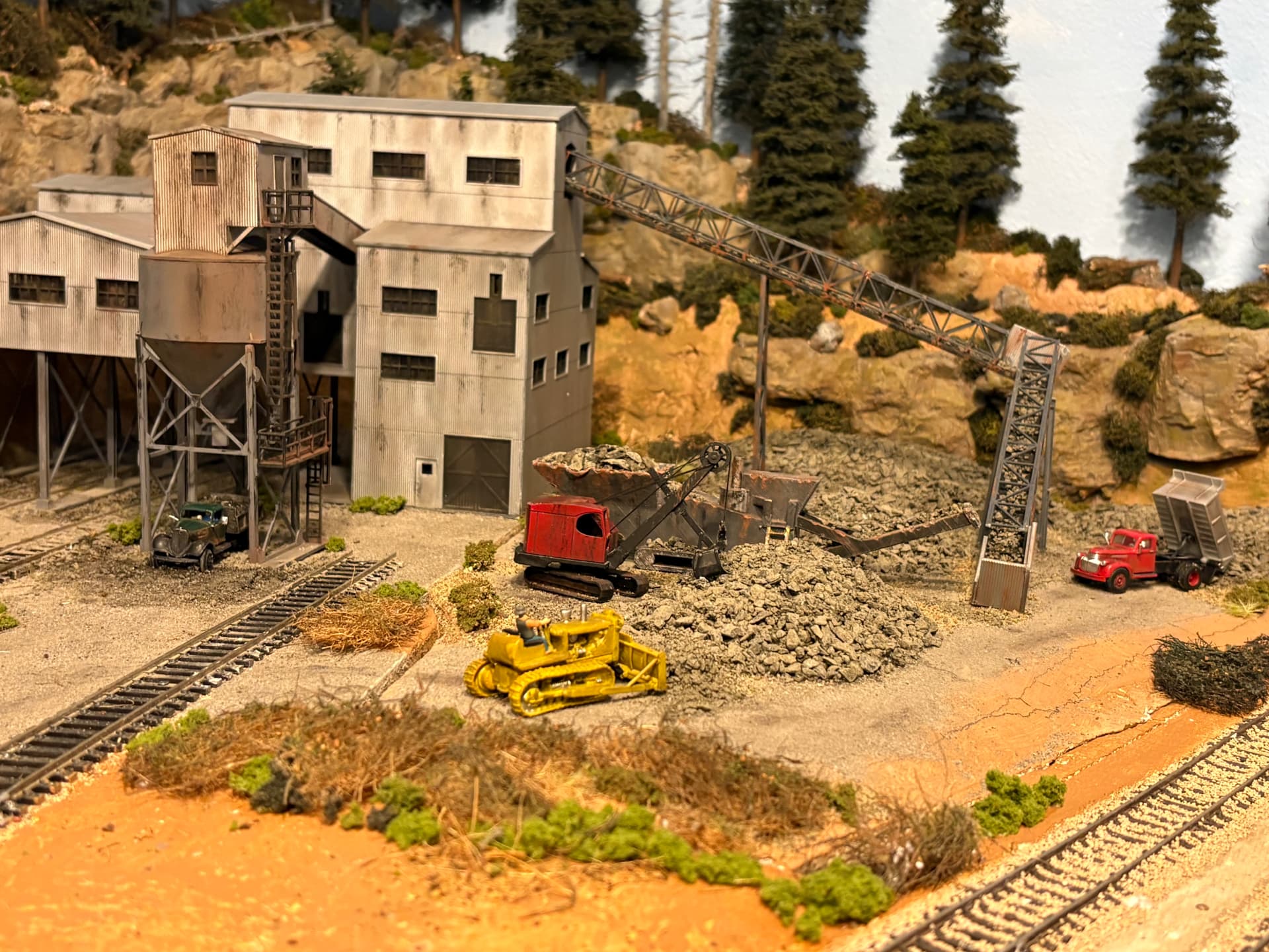

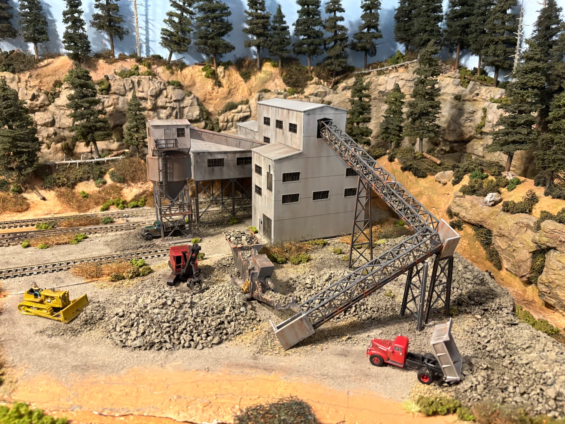

So, what I finally did was purchase a five gallon bucket of 3/8 minus gravel from a local landscape supplier, washed a couple of cottage cheese sized containers of it and then after it dried sifted it down into progressively smaller sizes.
I then carved pink foam bases and applied foam friendly adhesive with a caulk gun onto those and then poured the desired size of sifted rock onto it, pressing the rock a bit into the adhesive (wear latex gloves). After the first application of affixed rock dried, I brushed white glue on the bare spots, or where I wanted different sized rocks, and added those. This last part took a bit of fussing and fixing until I had the look I was satisfied with.
I am quite pleased with the final look. Here are some photos of the results.
