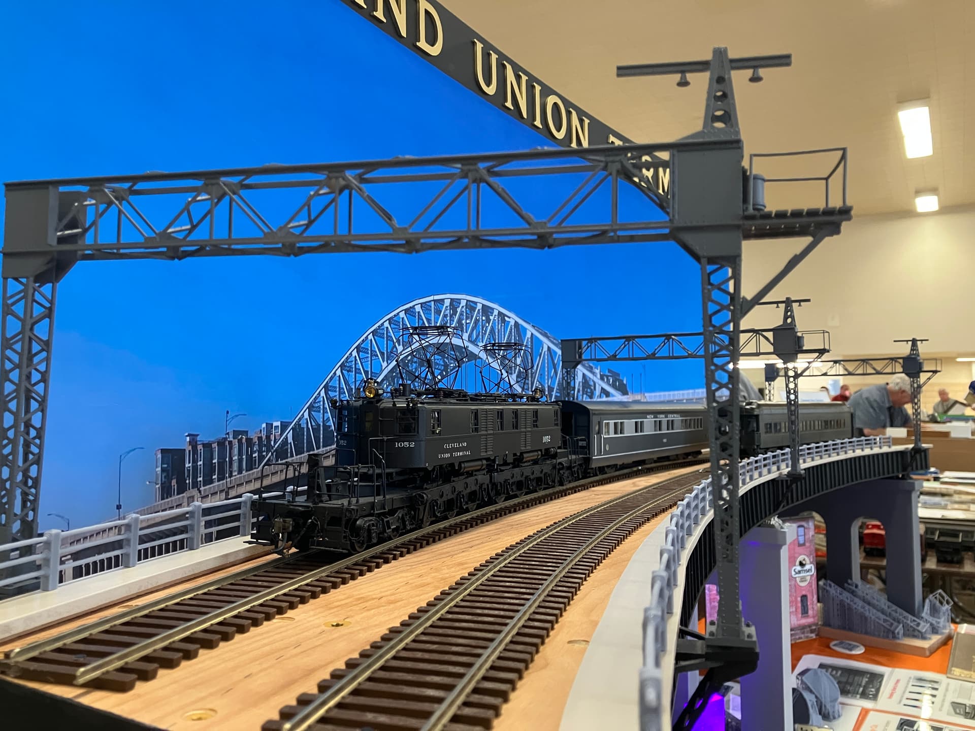

FYI in case this helps, I have been generating the unique CUT catenary, signals and viaduct approach pier designs in O-scale for 3D printing. The .stl files are freely available here, and could be rescaled to accomodate other scales. Please keep in mind you will need a high quality resin print machine to reproduce them:
