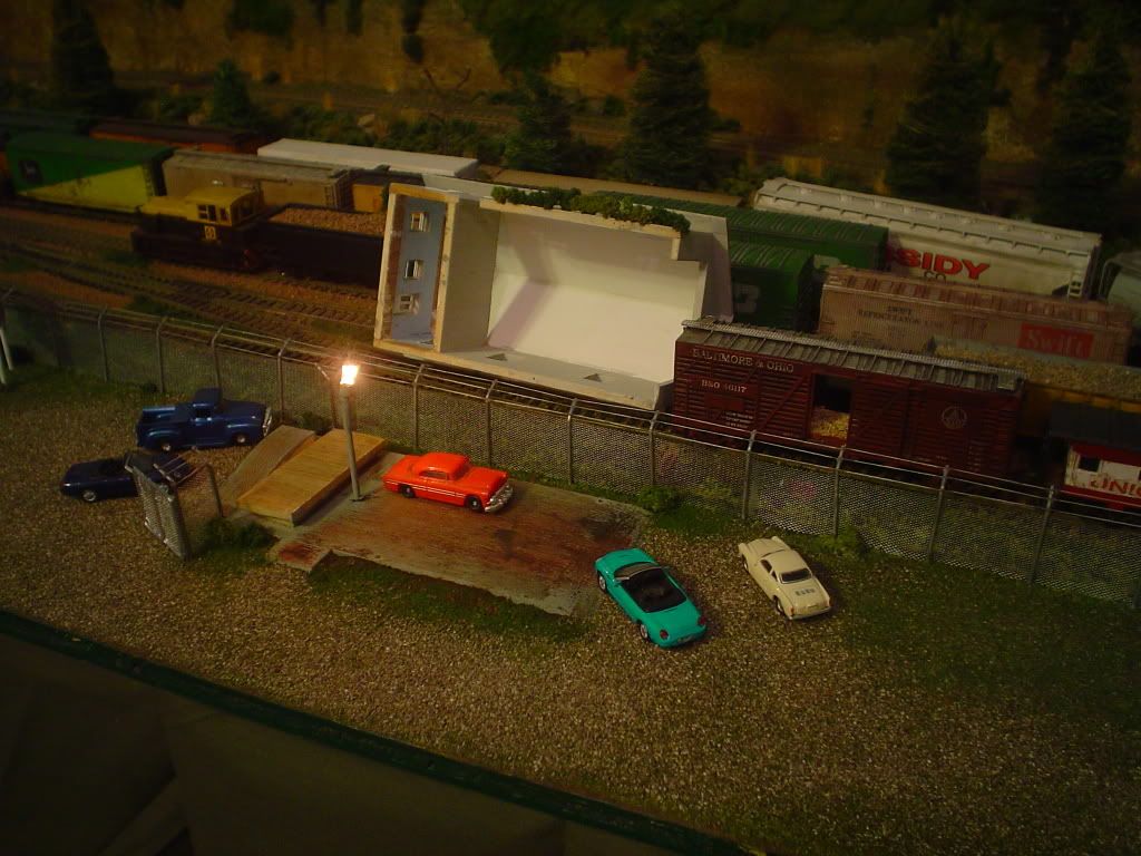

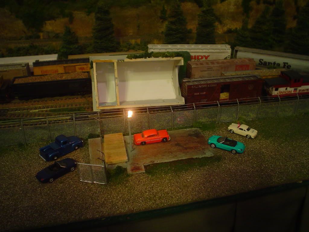

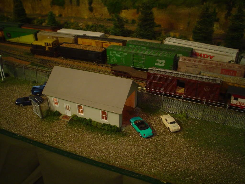

Hello and may I be the first to welcome you to the forums. What I have been doing is I have already placed my ground cover and when I deside to put up a new building, I simply wet the area and scrape off the ground cover and attach the wood base, (I scratch build everything) then the building will simply sit on the base. Hope this helps, I will post some pics of one I have been working on later. Mike
Here are a few pics
