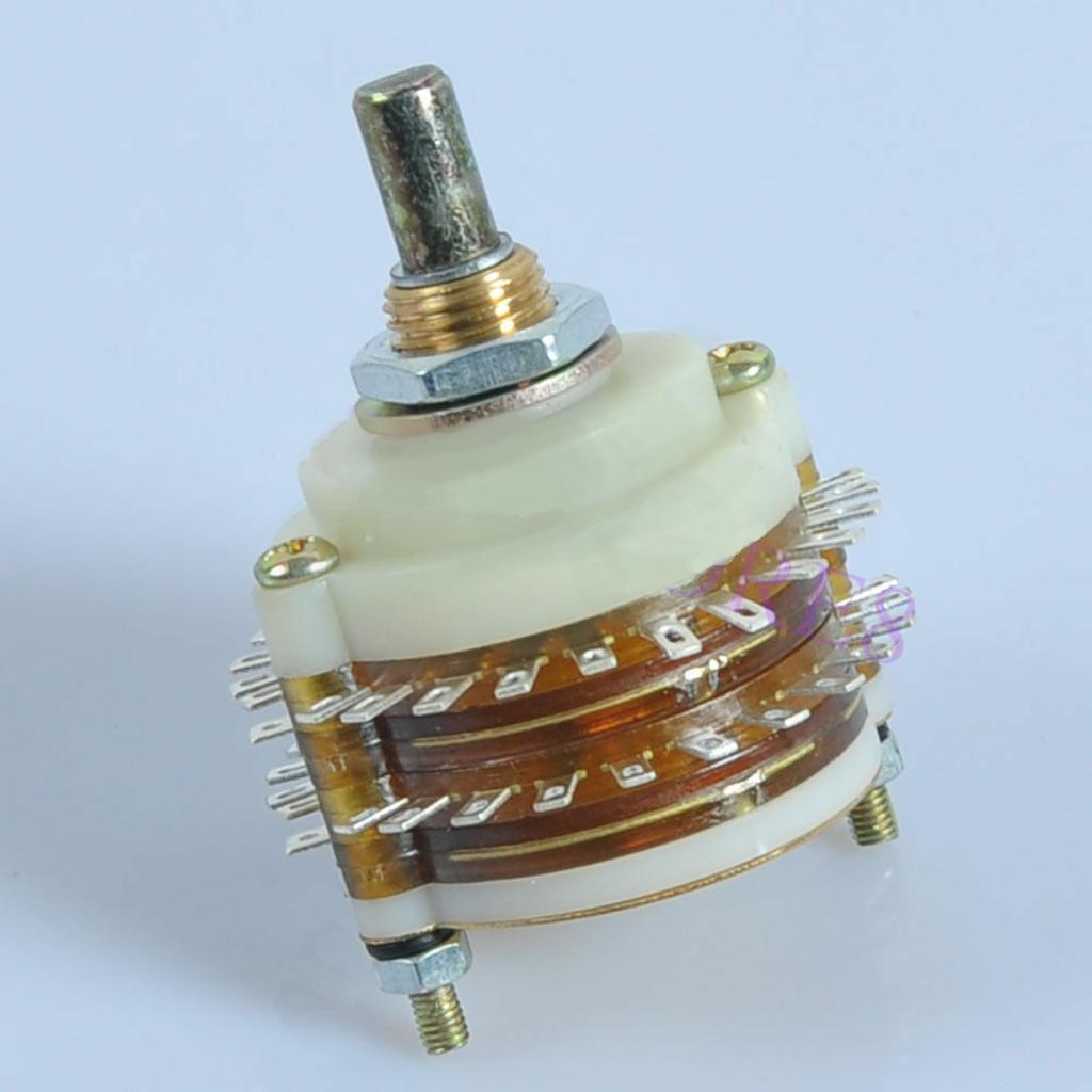

Using DCC switching would be quite costly, I would just use a rotary switch. I went with a 2pole 23 position rotary switch for my layout. I only have 5 stalls but the 23 position switch has 15° positioning and looks much better close spaced on my control panel.
https://www.ebay.com/itm/OAK-GLASS-EPOXY-ROTARY-SWITCH-2-POLE-24-POSITIONS-NON-SHORTING-NOS/233576825641?epid=20028386701&hash=item3662438329:g:qdwAAOSwi1lb8ba9
I use the 23 position switch to select the turntable position and individual DPDT center off toggles for stall track power. I operate dual mode on my layout, DC or DCC, and the reversing toggles work very nice in DC mode.

Ok. I just wanted to make sure I wasn’t missing something. I did find a 24 position rotary that will work. My concern with DCC is having multiple engines starting up simultaneously. I might also do dual mode since I still have several non converted engines.
