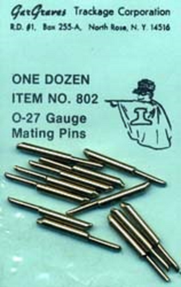

The short answer is, you can mix them, but it might be a bit messy. Now, I haven’t worked directly with Gargraves myself, but, in general, mixing track requires two things: adapter pins (I’ll explain them in a moment) and shims (these are the easy ones; just some thin scraps of wood shaved to the right height).
The adapter pins can be 3D printed or the like, and Gargraves made some at one point too. There’s some for sale on Ebay and Trainz.com. However, if you’re doing this on a permanent layout, you don’t have to worry about those, just use the smaller of the two types of pins (which I believe should be Gargraves) and stick them into the holes of the other track. It’ll be loose, but once you screw the track down it’ll be secure, and the probable spotty electrical connectivity can be rectified by using feeders on both sides of the joint. I’ve used the same technique to intermix O27 and full O.
All that being said, the visual transition might be harder to pull off than the mechanical one…
Yeah, those are like the ones I put in the links!
Thanks so much! So there are transition pins for 027; are they also necessary to transition to regular O gauge track? Pretty much only need on the remote switches to track connections.

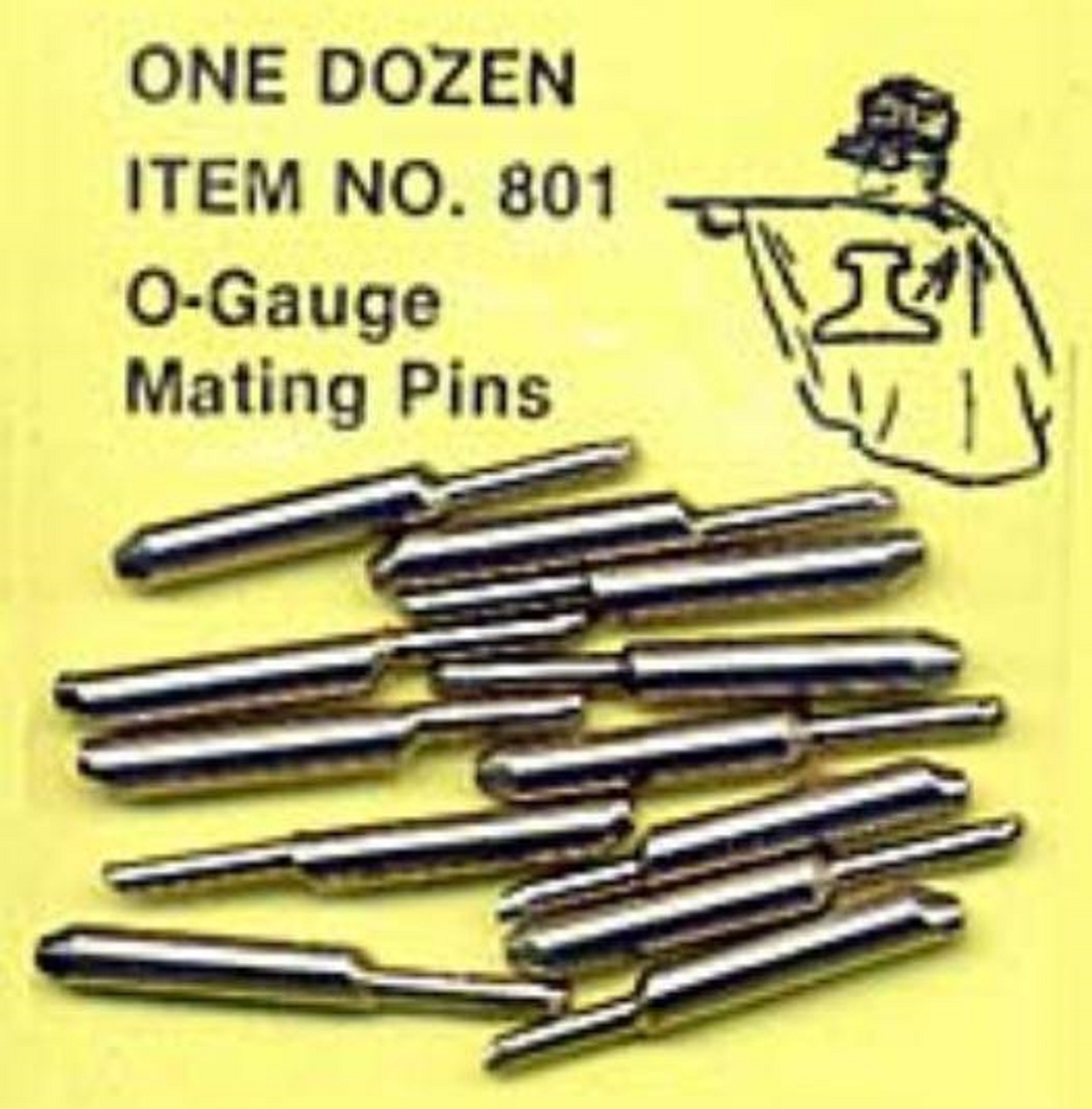

Oops! That second pic didn’t display on my iPhone until I refreshed it. My bad.
In that case, especially if you use the O Gauge pins, you will have no problem except for the insulated pin that turnouts need. Now, I don’t believe Gargraves made any insulating transition pins, so some jiggery-pokery will be needed. Perhaps you can try filing down the standard Lionel pins until they fit, or, if you or someone you know has a 3D printer, then the pins could be printed. I’d do it myself except all my printers are currently engaged in some kind of rebellion.

When using standard O, the height difference is 1/4". I have some prebuilt “modules” for floor use on 1/4" plywood, and they transition perfectly to standard O tubular using Gargraves pins.
Thanks Ben. I was thinking that I might need to do something like what you did. Now I know how!
