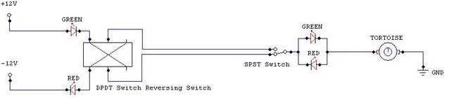

If you have a bipolar power supply(easily made with two matching regular power supplies), here is a circuit that will let you control a Tortoise from two locations and gives LED indication of the alignment at each location wihtout requireing running a bunch of wires back and forth:
