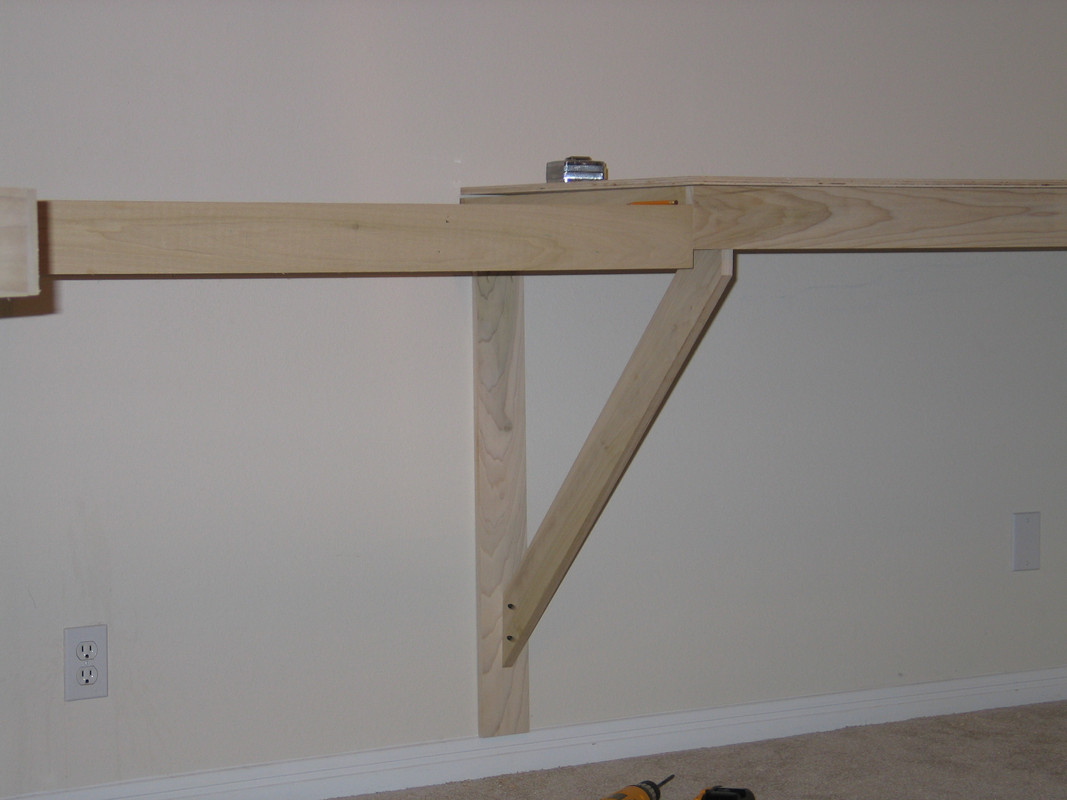

This section of benchwork protruded from the wall 22". I had no legs touching the floor and the benchwork was strong enough for me to sit on it. Shot the vertical flat to the stud, then pocket holed the angle brace to the wall piece and then the frame of the layout.

DonJ Thanks for the pic. Your example would be ideal but may not work with my equipment storage limitations.

Belated thanks to everyone who offered advice on the original cantilever question, I went with a design that uses a brace and gussets to transfer the load back down to the wall footing. Here is a photo of the support brackets I posted a couple of weeks ago in WPF.
