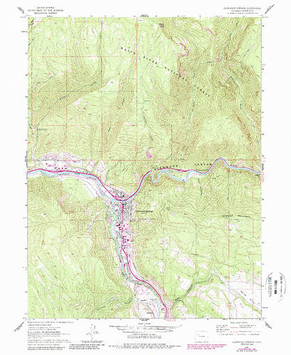

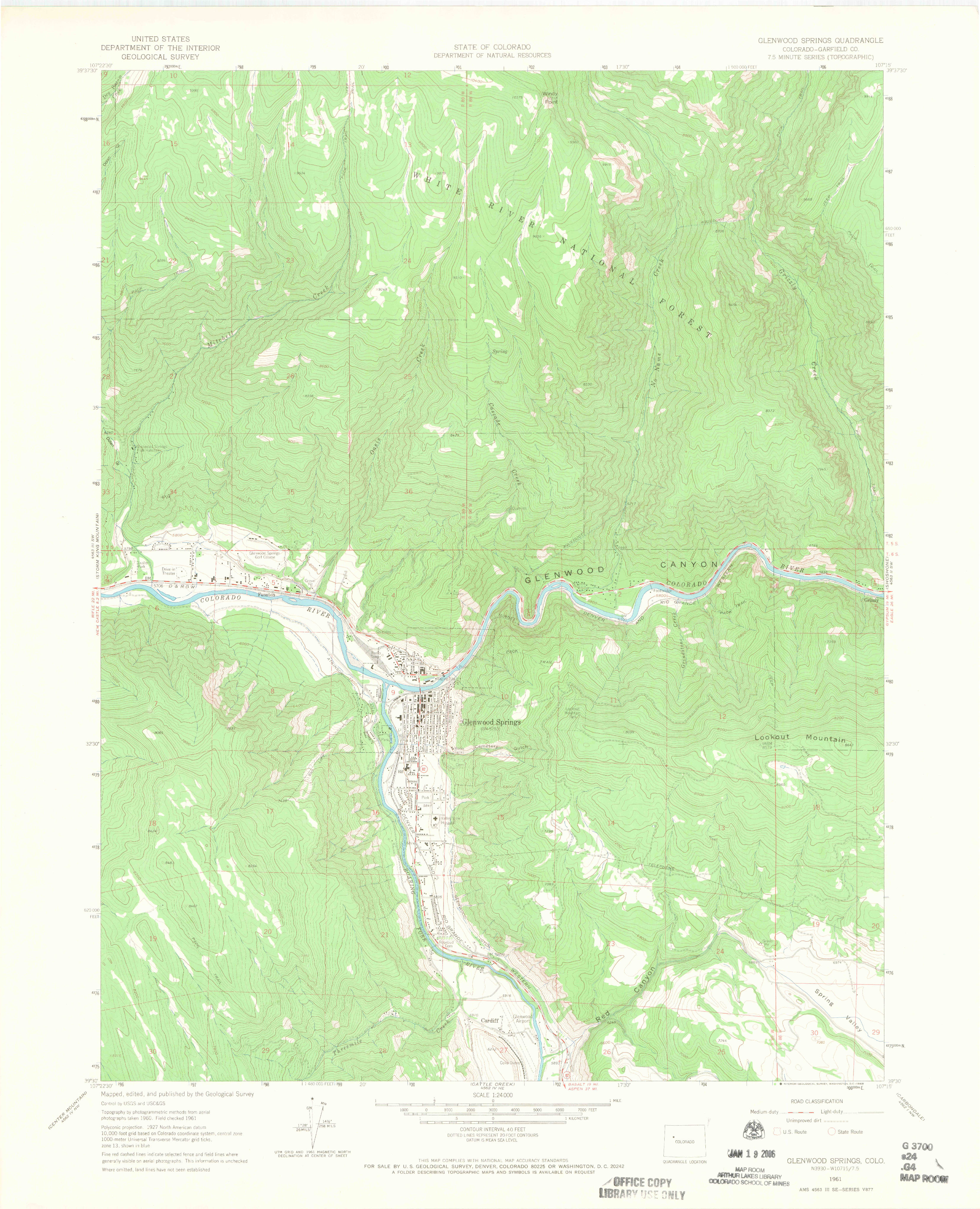

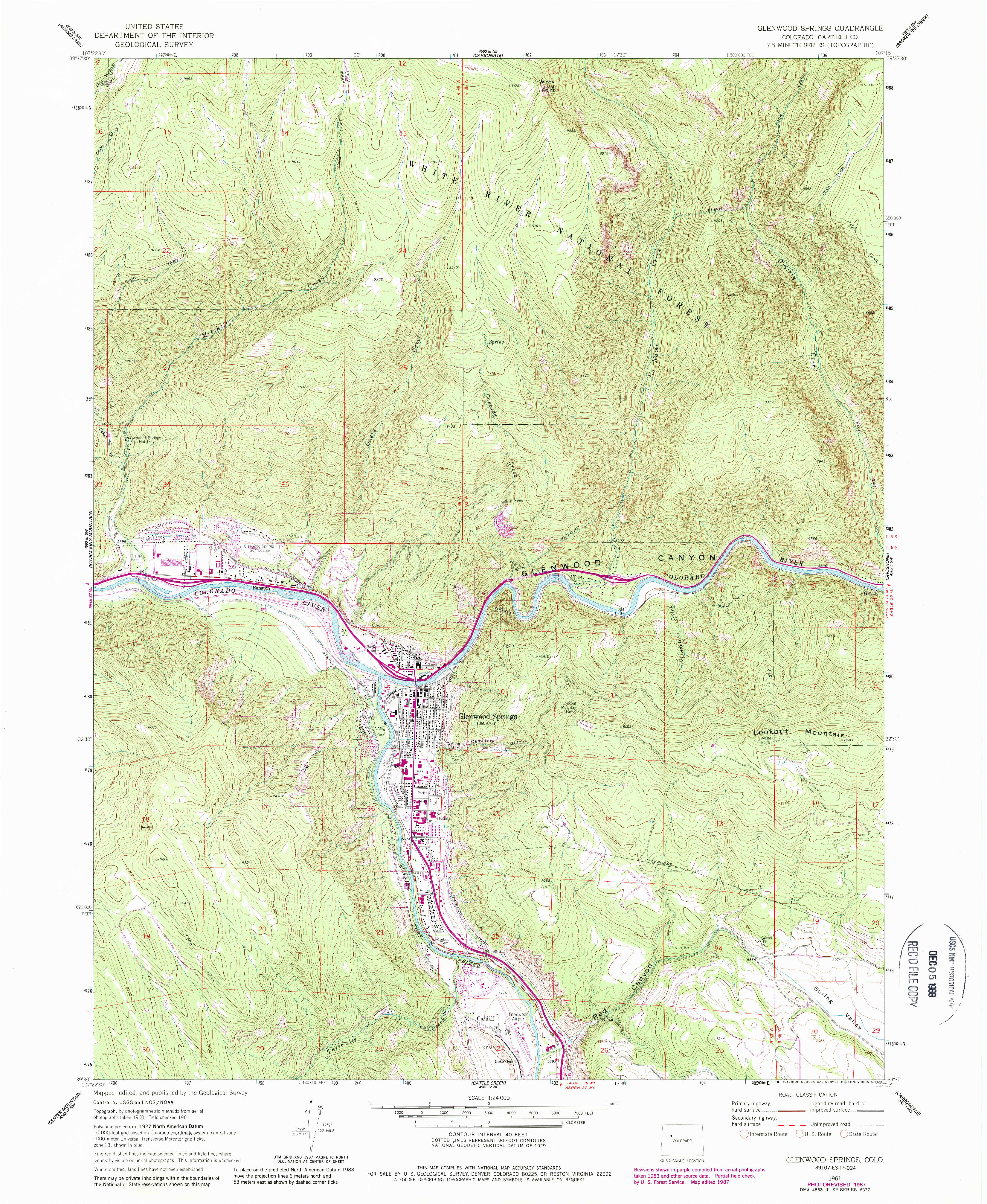

I assume that the air charts are up to date for air navigation, but they are out of date with regard to rail lines. The D&RGW line west of the Glenwood Springs station originally crossed the Colorado River from the south side to the north side. However, when I-70 was built, the rail line was moved to the abandoned Colorado Midland grade for several miles west.
Here is a USGS topo map before the interstate:
Here is the map after I-70 construction:
To see all topo maps:
