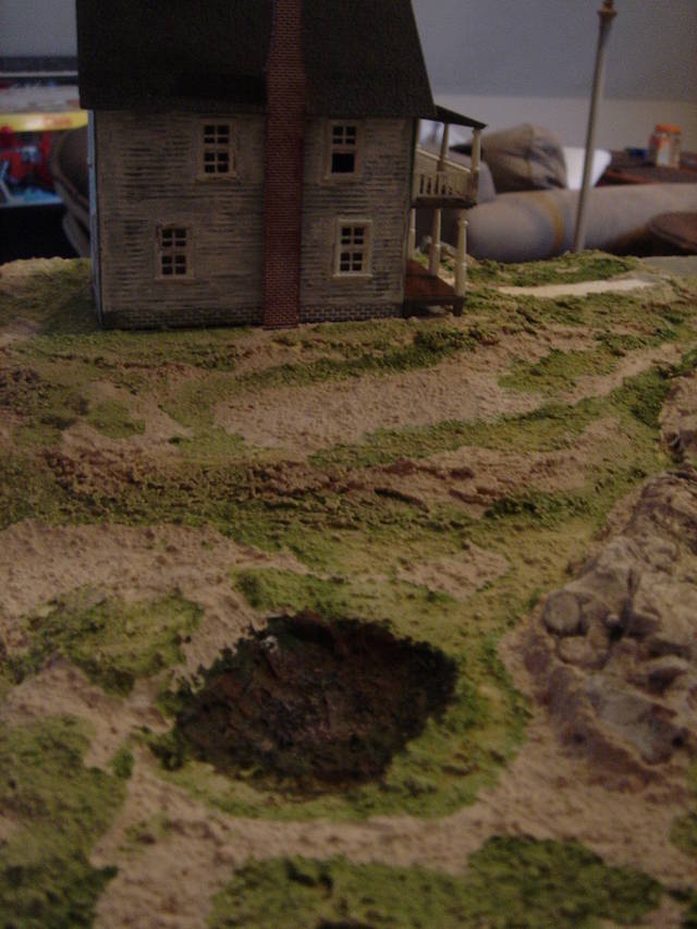

I use a skim-coat of Gypsolite over most of my “natural” scenery. Gypsolite is a gritty plaster. I mix it thin, almost a slurry, and coat all the plaster cloth. I find it’s easy to work it between rock castings so it looks like the rocks are poking up through the “earth” rather than sitting on top of it. The Gypsolite gives me a rough surface that looks much more natural (to me, anyway) than plaster cloth or pink foam alone. I add a bit of brown craft paint so the Gypsolite, which is naturally a pale gray, comes out tan.

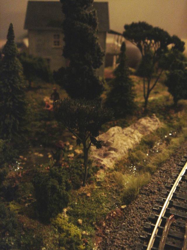

In that picture, I’ve already painted on a “camouflage” pattern using a thinned wash of green acrylic craft paint. After that, I apply talus, turf, ground foam, trees, tall grass and, if you look closely, a hillbilly out hunting.
Over the years, I’ve accumulated several different cannisters each of turf and ground foam, and different colors of field grass. I apply all of these by hand, using small pinches of each to create a non-uniform scene.
