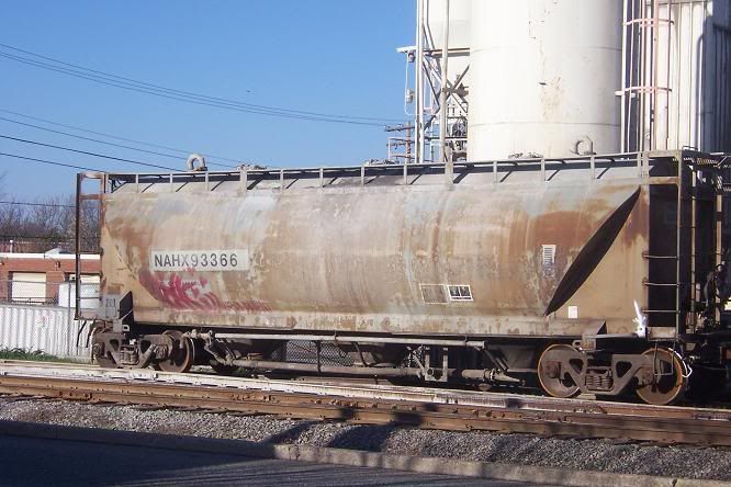

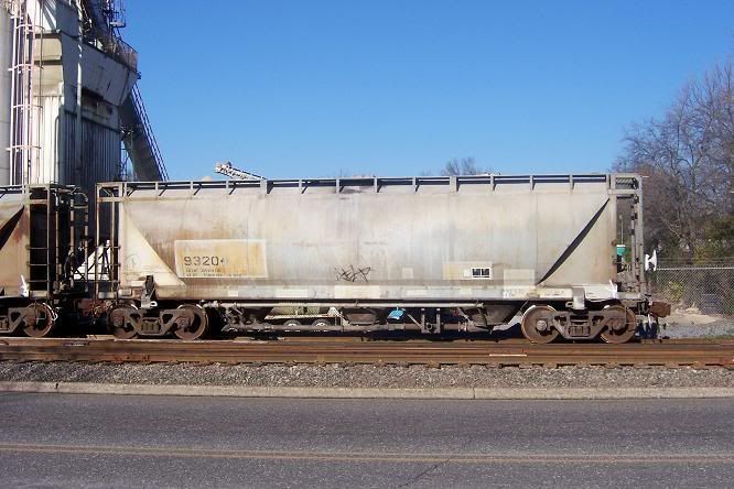

Heres a few shots of one in NC. I use to go there quite a bit to see some NS. That cement plant only holds about 2-3 cars. The rail line leads to a fiberglass plant (PPG). I was also told that the plant has one of NC biggest turn arounds in the facility for the engines.
This cement place had the cement mixers and a few trucks. I am sure some of the hoppers were carrying sand, or what not.
I’m sorry i don’t have good shots of it. When I was in NC to visit i just got the train cars.
