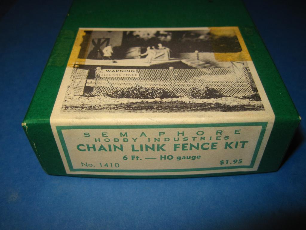

I watch for craftsman kits on eBay. The Semaphore Hobby Industries #1410 is the best and most realistic chain link fence I’ve run across. I think they were bought out by Alloy Forms (H2009). There are a couple on eBay this morning.
Check the pictures on eBay for this box too
Good Luck
