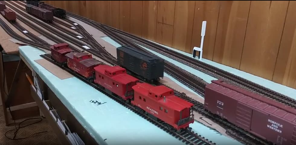

i replace plastic with metal wheels. My understanding is that they roll better and are less likely to accumulate the gunk seen on plastic wheels.
some quick tests on a few cars found that the roll on a 1.5% grade. I classify cars using a mini-hump allowing cars to roll into yard tracks
