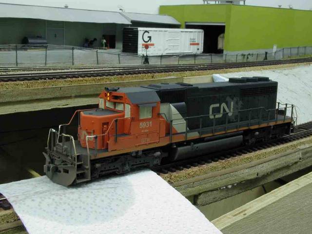

I also need to clean the wheels on my locos from time to time. The best method I have found and works very well is to take a sectoin of track and hook up a power pack to the rails (I use alagator clips) then lay a paper towel over about half of the track. Wet the paper towel with alchol and put the loco on the track with one set of wheels on the wet paper towel and the other set of wheels on the bare tack. Hold the loco and let the wheels on the bare track spin and the other set will spin on the wet paper towel cleaning the set of wheels. Do this with each set of wheels until the loco doesn’t leave any black on the towel.
This works very well but keep in mind that the alchol is flamable so use caution . Hope this will help you. Mike
I do the samething Mike does. It works very well and probably is the fastest way to clean wheels. Use the blue Shop Towels paper towels for extra durability.

I have used the rail and cloth method as well. HOWEVER, I laid 2 metal plates separated with a plastic strip insulater on a section of track near my loco servicing faciltiy. The metal strips are in contact with the rails and provide power to the TREADS of the wheels, NOT the wheel itself, as the constant grinding can wear the nickle plating off. So one set of trucks are on the powered metal strips, while the other truck sits over cotton cloth laid on top of the rail. This gets the inside treads clean as well as I run the engine full power to scrub the grime off. The metal strips simply look like a grade crossing, or work area for maintenace of the engines, which in fact it really is!!
I only use cleaning solutions if the grime is really caked on, but with normal use and a lot of running, I simply only need to use a regular section of cotton cloth I keep handy near the area. The slightest balking of enigine power and the wheels get cleaned. It takes about 10 seconds per truck and you have a squeaky clean running system.
