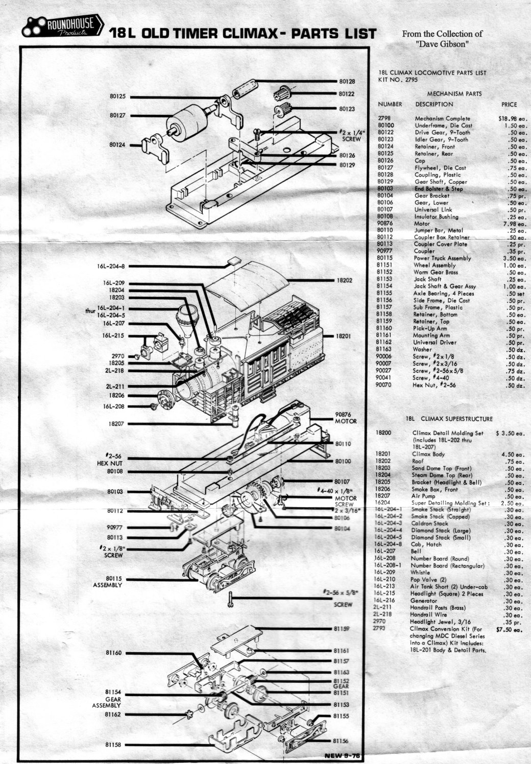

If you look closely at this exploded diagram from Hoseeker you will see there is a lot going on in the way of gear boxes & drives. All of which contribute to the noise. If it moves along back & forth ok without binding & stopping, then ignore the noise & go with it. You can tweak them, but that is a whole other sub-cult.
http://hoseeker.com/assemblyexplosionMdc/roundhouse18lClimaxpg4.jpg
