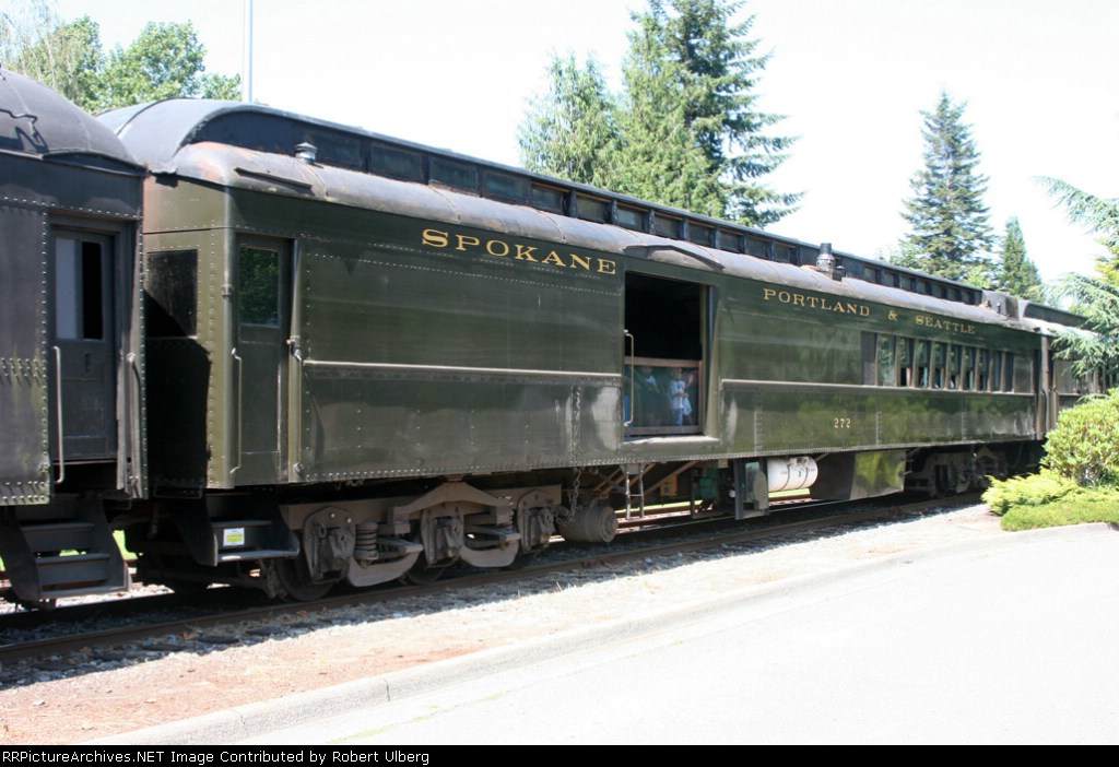

SP&S, and later BN, had the last scheduled mixed freight in the country, lasting up until Amtrak (hope I got that right).
There were two cars used in this passenger service: SP&S 272 and 273.
Here’s 272, all gussied up:
And here’s a model of 273:
They were used as passenger accomodations on a daily (except Sunday) mixed train between Wishram WA and Bend OR. On the model, you’ll see an extended window–this car was also the caboose–and the conductor or brakeman would/could sit there. There was not a separate caboose–no need.
Heat was supplied by a propane stove in the passenger compartment, and one in the baggage section.
I believe the cars were turned at each end. There aren’t too many photos of the train, as it mostly ran in the dark. It was a pretty long run, and it was easy to turn at Wishram and Bend, as there were wyes at each place.
Ed

Your photo of 272 is probably taken up the road from me on the Snoqualmie Railroad Museum at the depot there, no? I’ve seen that car and we even rode in an observation car in a train that had 272 in the consist.

Yeah, 272 and 273 were (actually, “are”) pretty long, at about 80’. They were each converted coaches, 272 done in 1955, 273 in 1956.
Yes, 272 was photographed at the Museum. I’m glad it’s got a nice home.
