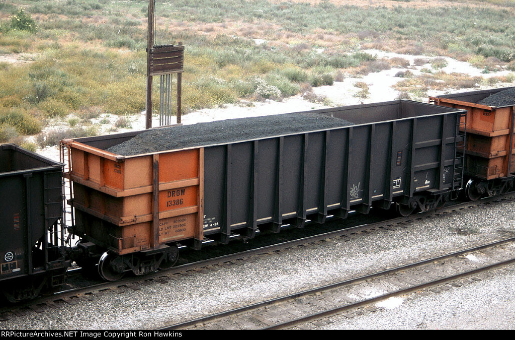

This load is relatively tall, with a rounded profile…

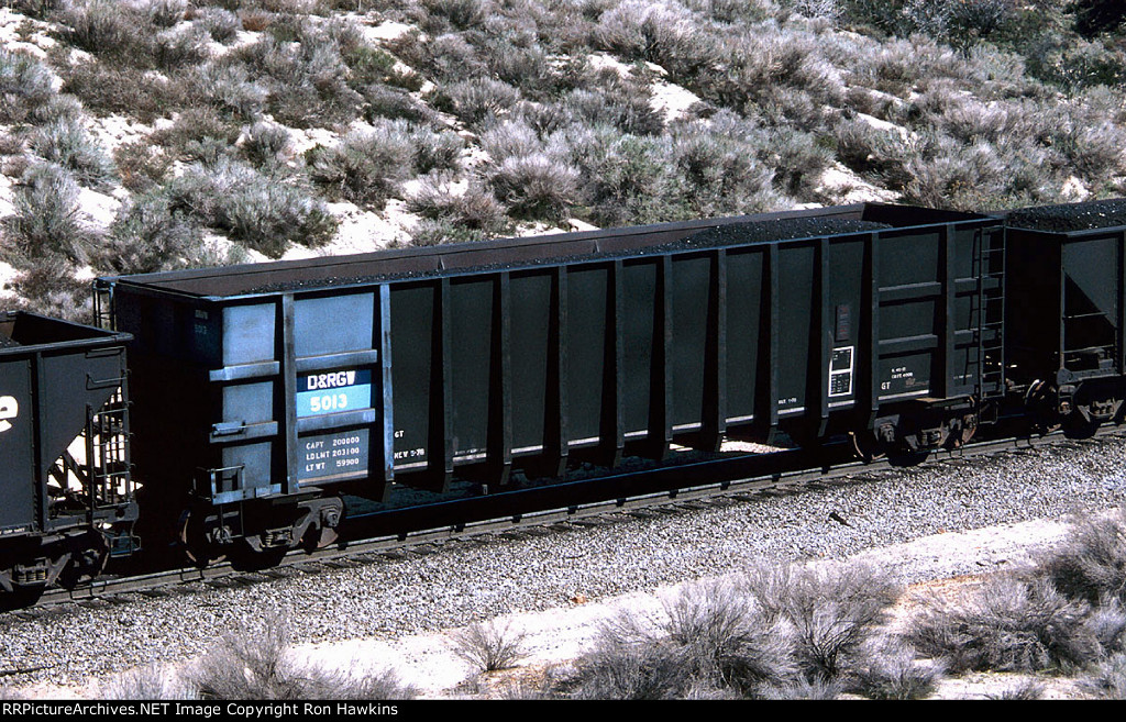

While this one is lower and flatter.
Based on what I’ve seen in hoppers, I’d guess gondolas to be pretty-full, too.
Here are a few examples:

Given the era I model, I would give the first set of pictures a little more credence for what I need (ACI era). However, if anyone has any photos, first-hand knowledge, etc. about the practices from the coal loaders out of Colstrip, MT, that would be even more helpful. (Burlington Northern) Lacking that, I will leave the loads as they are and do a little bit of clean up work on the cars. (The ladder mounting holes are showing a little too much for my liking otherwise.)
As an aside, the photos I found are of cars acquired by the D&RGW from other owners, pictured well after the ACI requirement was dropped. The first photo is from 1995, the other was dated 1982.
I guess the DRG&W wasn’t real agressive about removing the ACI tags from their cars.
Almost nobody was. There was no requirement to remove them, so it was rare for the ACI plate to be taken off. Surviving cars from that era for the most part still have the plate, either painted over or weathered until it’s illegible.
One thing I would suggest is that you make sure to vary the height and facing of the loads from car to car, and possibly bolster one end of the load more than the other. Loose loads like coal or gravel did not shift about identically or even mound into the cars identically. The general shapes were similar, but not uniform, so with cast load pieces it helps the look to take some extra steps like this.
