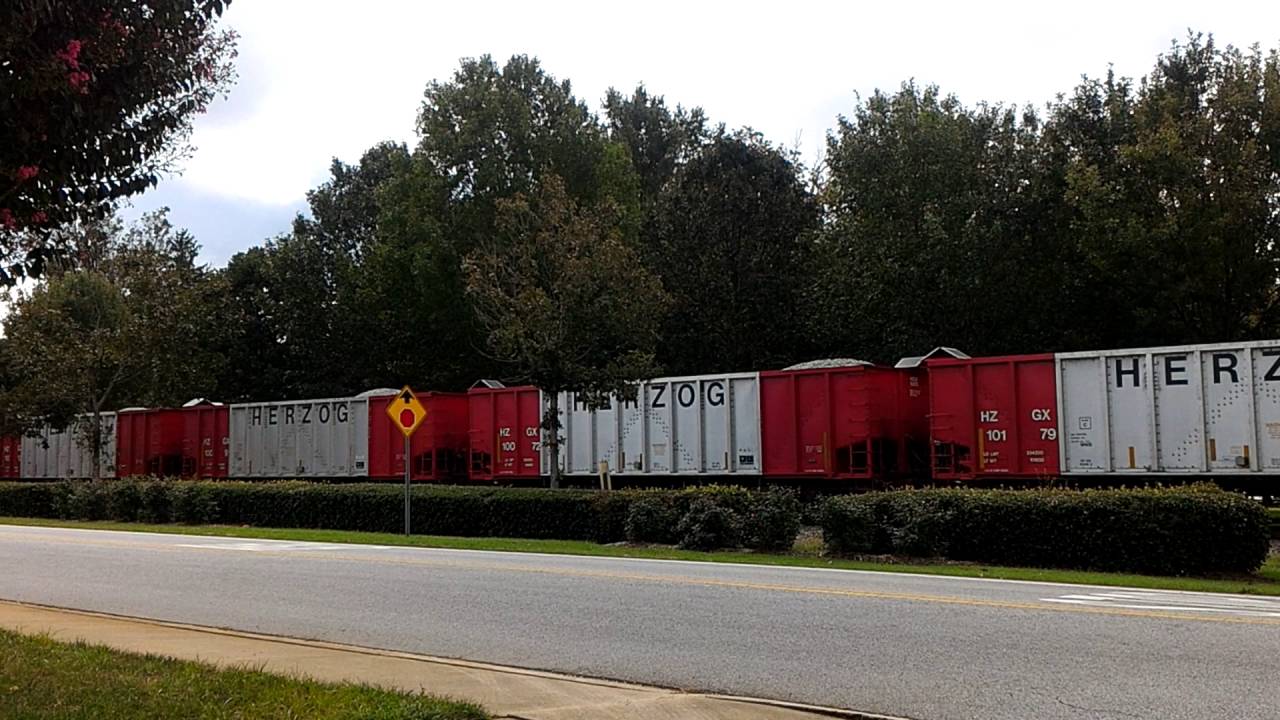

Those Herzog cars are heavily rebuilt as ballast hoppers though.
A straight “BethGON” car would be singulary useless for ballast since you can’t dump it anywhere.
A regular flat-bottom mill gon would be more useful than a “BethGon” type with sloped and rounded floors, as you could at least unload that car with a excavator type machine in the car to apply rock to the sides of the track, but still really not great for actually doing ballast work.
Really anything other than a proper ballast car is less than ideal.
Edit - I guess the original post only mentioned gravel, not necesarily ballast. So yeah, any type of regular discharging hopper. Some operations do load/unload standard gondolas with a backhoe. BethGon, very not ideal in any way.
