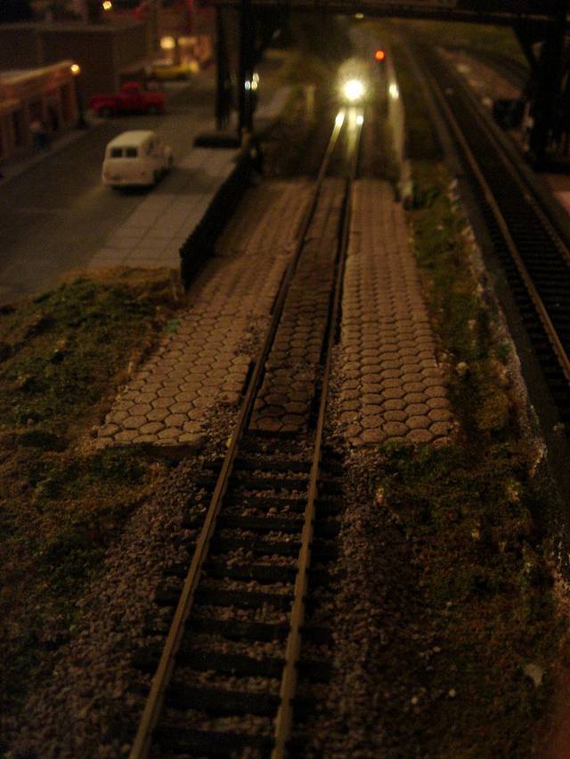

This is the trolley stop, where I did put cobbles between the rails:
I had to make my own cobblestones, by the way. I ordered a piece of “plastic beehive” from beekeeping place in Maryland. I took modelling clay and made an impression of the plastic surface, and then used Woodland Scenics latex rubber to make a mold from the clay image. I used the mold to make Hydrocal castings, finally painting them with a speckled Rustoleum spray paint from a hardware store.
Your cobblestones look great.
