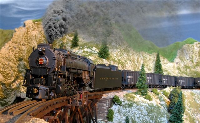

Dave, I always have this image in mind when I make the comments I did above, to which you responded. Would you agree that the rails in this image, weathered, are rather large for the scale of the other things visible? I think they look about 4" too high in scale, maybe more.

IIRC Code 100 is something like 156-lb. rail in HO, and one of the few railroads to use rail that heavy was the Pennsylvania, so maybe you’re actually not that far off?? [:D]

What a great picture, Crandell!
Have you thought about replacing the guardrails with code 83 rail? That would help considerably, I think.

To my eye, the “ballasting and painting you can’t tell the difference” approach doesn’t cut it. It helps, but Selector’s picture nicely illustrates the issue. This is because I think that the eye (and brain) take in everything in the scene and it all subtlety adds up to how real a given area looks on the layout. Another way to put it is that a scene that’s looks good with code 100 (IMHO) will look even better with code 83 or even 70.

Mark, yes I have considered that. Unfortunately, I haven’t gotten around to actually acquiring any stock…once I do, I will surely fix this. In fact, I may do it in Code 70 because I have to do the same for the other bridge on my layout…it currently has no guard rails.
Thank-you for your kindness…I kind of like that image myself.
