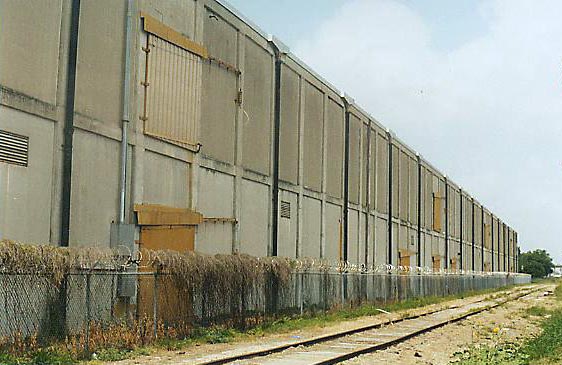

You mentioned height requirements. Old warehouse districts had lots of 3, 4 even 5 story buildings…
Isn’t this fun and railroady? But too tall for your space…
