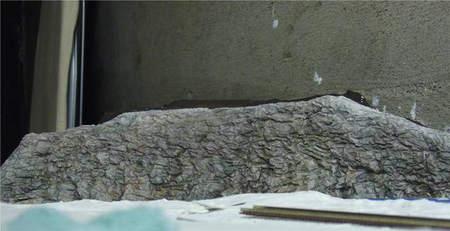

Jarrell,
I always wait until my plaster is dried and cured before applying any color. I use thin washes of paint to color the castings and I’m pleased with the results. Since you asked for a photo:
