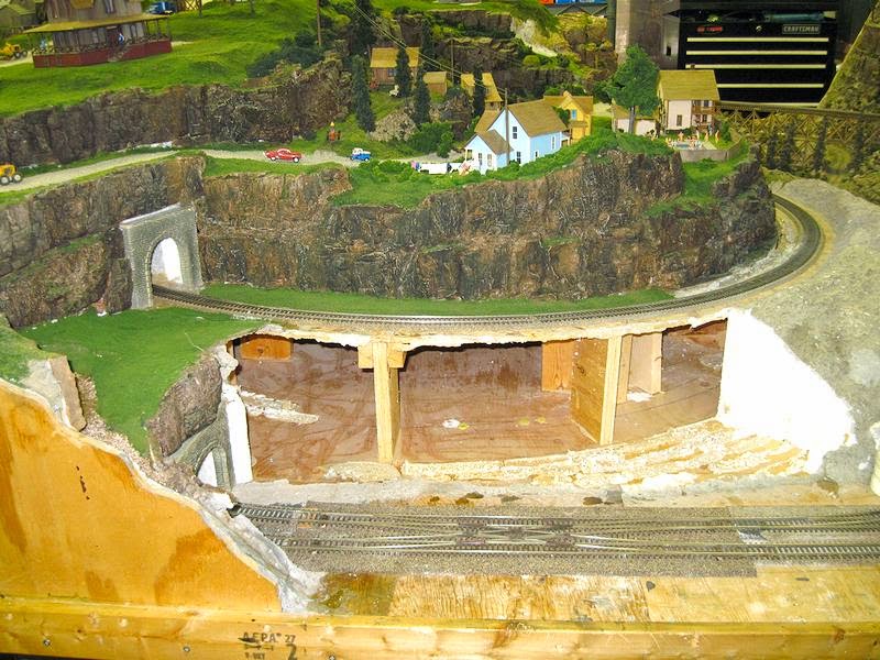

Over many years I’ve tried all kinds of methods to color plaster. I’ve mixed dry colors, latex paint, and India inks with the plaster mix, and painted finished plaster formations with acrylics, latex, and india inks as well. From the various attempts, which had different degrees of success, I quickly learned two things.
The first was learned on the large mountain tunnels of a late 1950s Lionel layout. When you paint the finished white plaster and cover with “ground cover”, it looks fine. But, any time something hits or scratches that area, you will end up with a bright white and very obvious result.
From the above, I learned to mix color (usually a brown) with the plaster so that any “hits” would not be readily apparent.
The second thing I learned (the hard way of course) was on the first room filling HO layout I built in the mid '90s. I had a raised second level, with rock and cliffs spanning that level to the base - literally around the entire layout (15x11). I had colored the plaster mix, and then using acrylics painted the resulting rock formations and walls. What I didn’t realize (read all about it later on in MR) was that the paints dry darker than when they are first applied.
So I ended up with very dark brown/grey rock surfaces, that IMO were more depressing than impressive. And over the 12 year life of the layout I tried to lighten them, but was just never successful. To paraphrase Emeril, “you can always add color, but you can’t take it away”.
