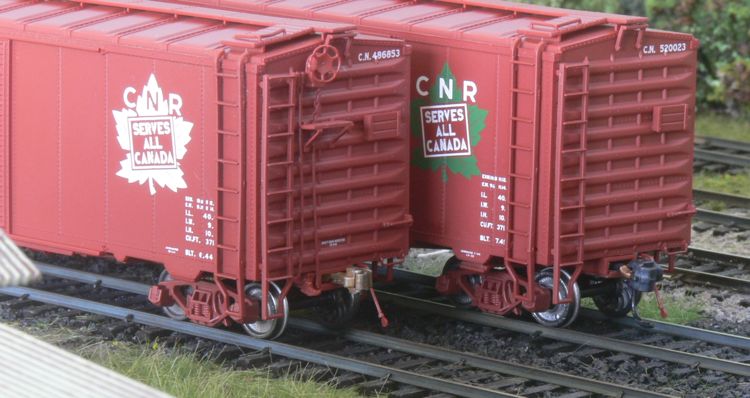

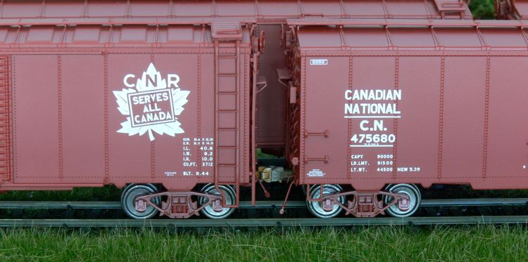

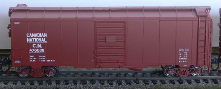

One smaller manufacturer that has been left out is TrueLine Trains. TrueLine primarily does Canadian prototypes and their subsidiaries.
They make some fantastic RTR rolling stock, including some 1937 AAR 40’ box cars.
I just received mine a few weeks ago, here are a couple of shots (I don’t have one of their underbody, but the brake detail, piping, etc is excellent).
They come equipped with knuckle couplers (right, below) but I think they look even better with Sergents (left, below).
Now to weather them up!
Thanks for that link, Scarpia. [Y] I was looking at those cars in the LHS a couple of days ago, but not too closely. They were on sale at $29.00, and while they were an improvement over their earlier offering, too expensive for something that would require re-lettering to backdate it into the late '30s, plus a little other work. However, on seeing your photos and reading the Trueline info on the cars, I may reconsider. I hadn’t realised (didn’t take one out of the box [banghead]) that the flat roof was available, along with the NSC ends and 1937 BLT dates. They’ll still need those grabirons replaced (especially the ones on the roofwalk) and probably the stirrup steps, too, but the plain early paint schemes do make them more attractive to me.
With almost 40,000 cars in service between CNR and CPR, they should also be attractive to a lot of North American modellers (and modelers [swg]) of that era.

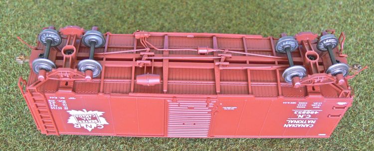

For others, I took a picture of the underside of one of the cars, so you’d have an idea of what lurks there.
