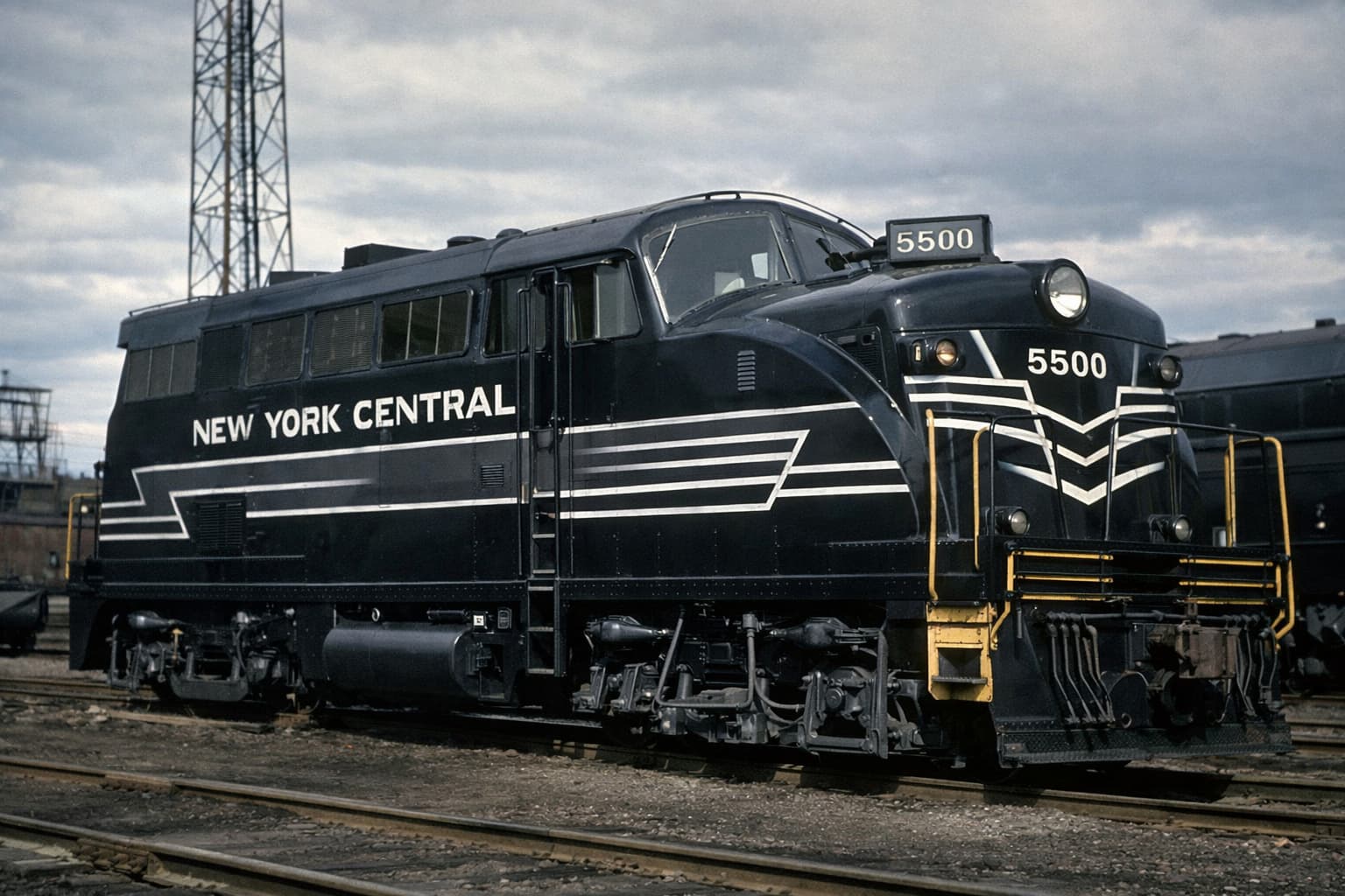

That’s for sure. And I’m grateful that the NYC didn’t partake. :slight_smile: Course, if they had…and had outfitted them with lightning stripes?..I’d likely have a more positive opinion of them - LOL. :laughing:
I don’t know, they look a bit better in that scheme.
Even if the AI did mess up the “chain guard”… and mis-painted the lightning stripes.
And don’t look too closely at the trucks.
See the Baldwin near-equivalent, the DRS-4b. Like a Gravel Gertie with B trucks… but it’s got lightning stripes on at least part of the carbody…
