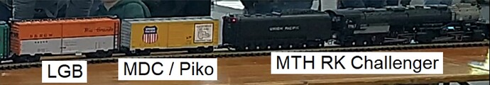

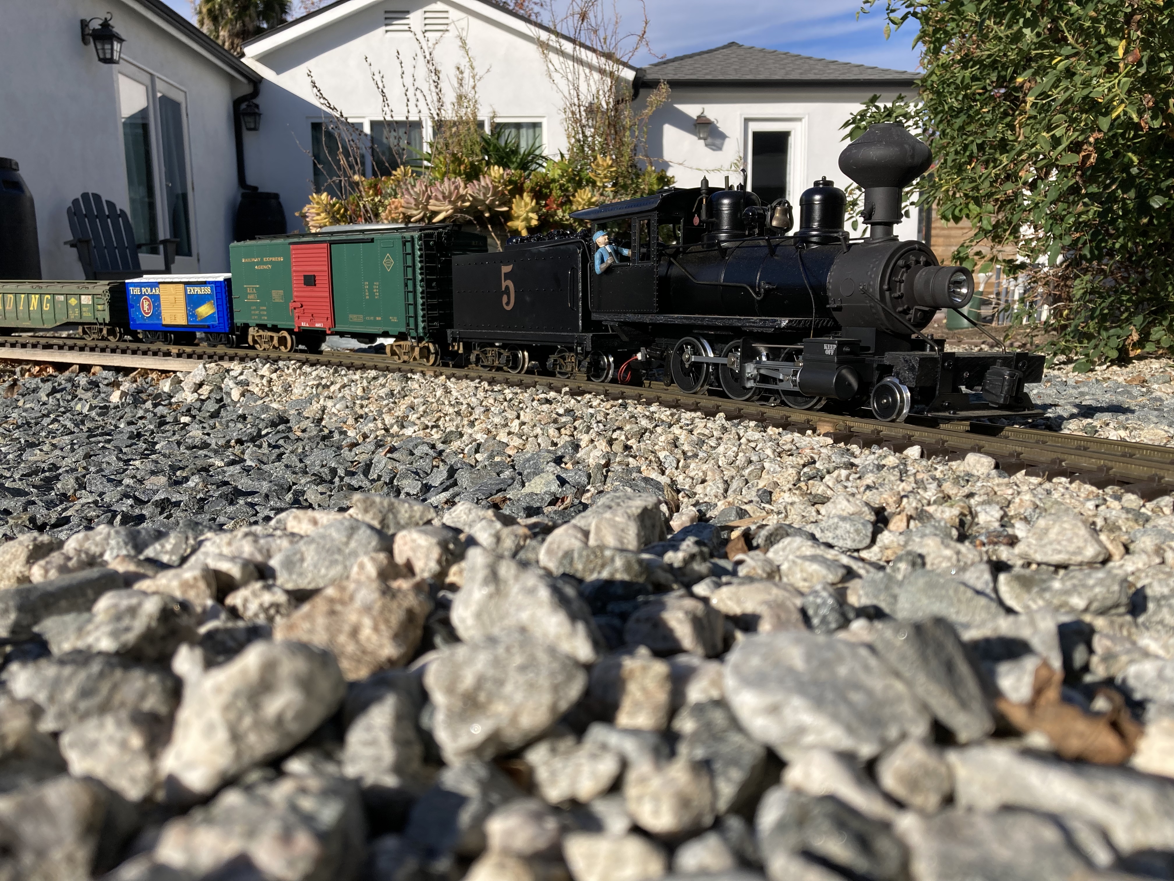

It seems to depend on what cars you are using. This photo is not mine and is from the internet, the locomotive and Piko reefer are 1:32, the LGB boxcar is 1:29, and they look perfectly fine together, as boxcar sizes and designes varied between railroads.

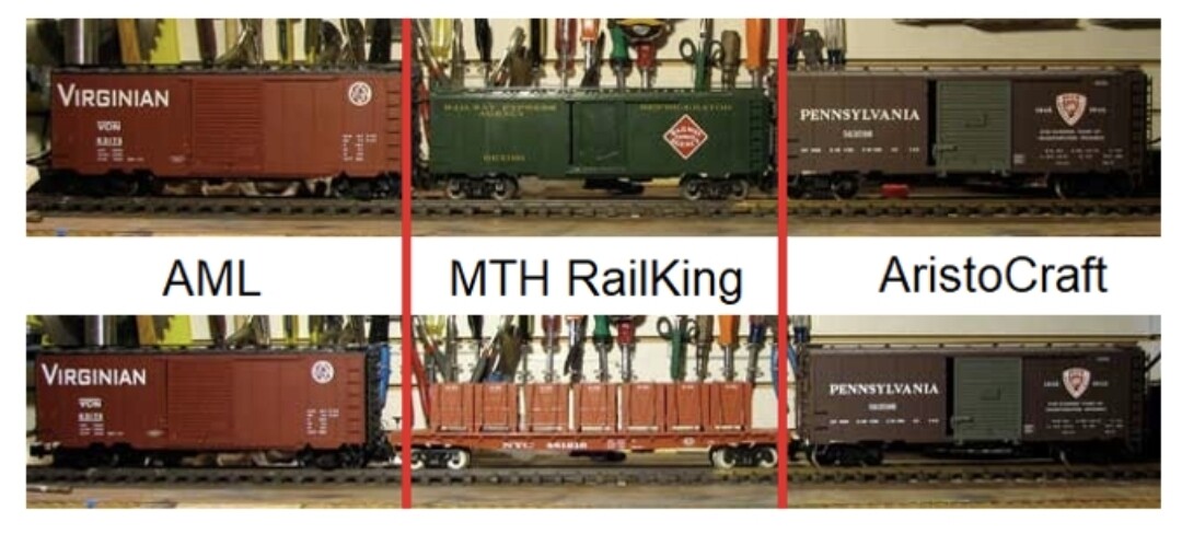

But on the other hand, comparing a MTH 1:32 reefer to 1:29 boxcars, it looks comically small. Although the 1:32 flatcar looks perfectly fine. (Also not my photo)
I would get a second opinion though, as my G gauge colection is mostly narrow gauge items, and I can’t say too much on size comparisons of things I don’t own. If someone can get this topic moved to Garden Railways, they can probably help you more.

It may help to know the MTH locomotive(s) in #1 gauge that you’re using. Some prototypes (like the Challenger pictured) work because few are familiar with the relative size of their tenders compared to following cars. You might also ‘stage’ the cars with one of two 1/32 cars and then 1:29 of increasing perceived size to make the transition less extreme (I suspect it would be perceived like forced perspective).
Some hood units or smaller locomotives, on the other hand, might just look too small or shrunken. That would be exacerbated by larger prototype cars, particularly auto rack or stack cars.

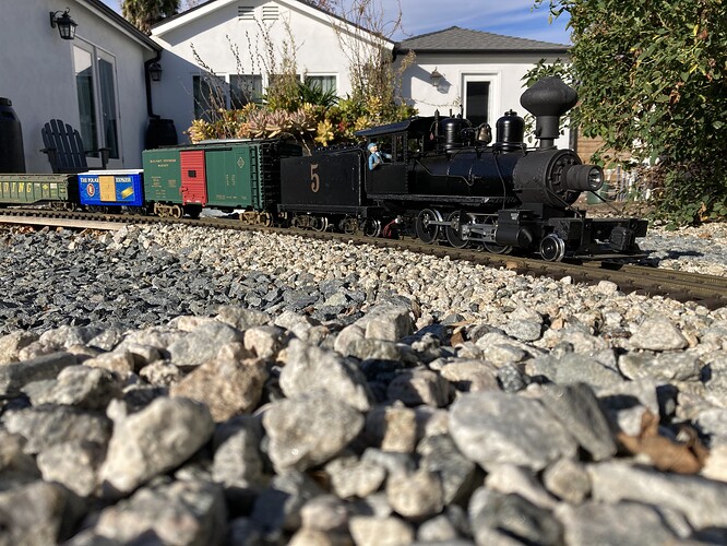

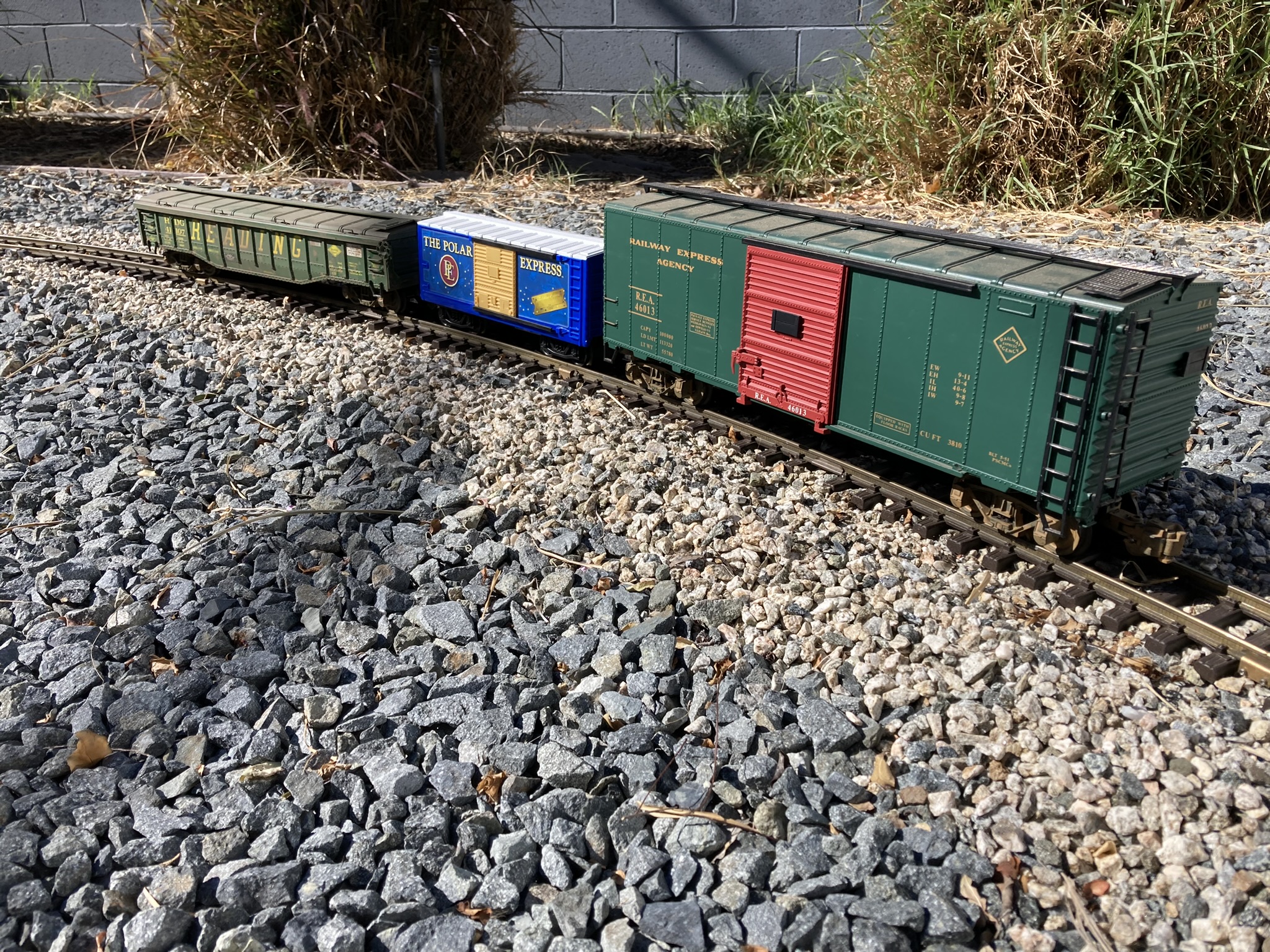

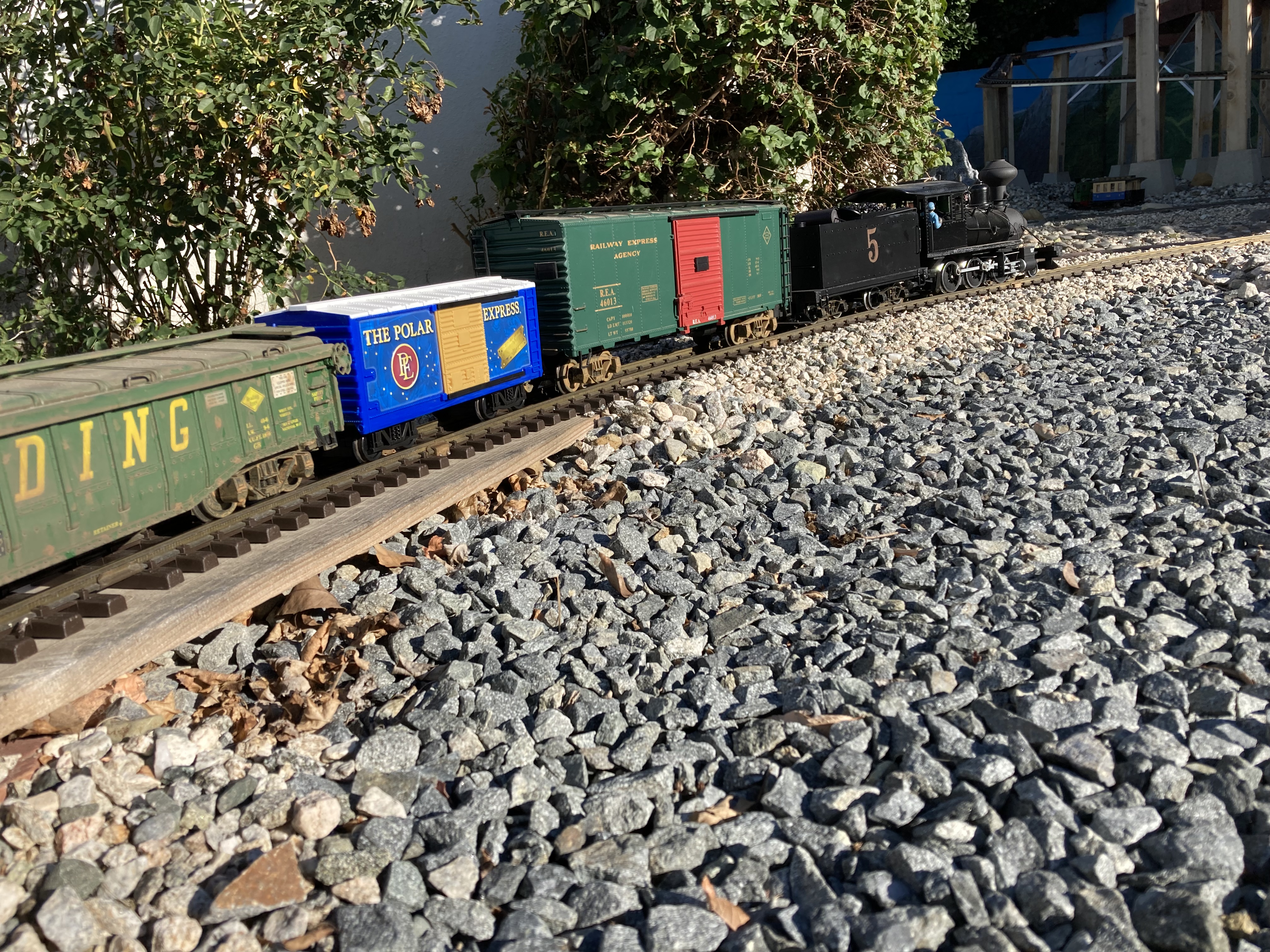

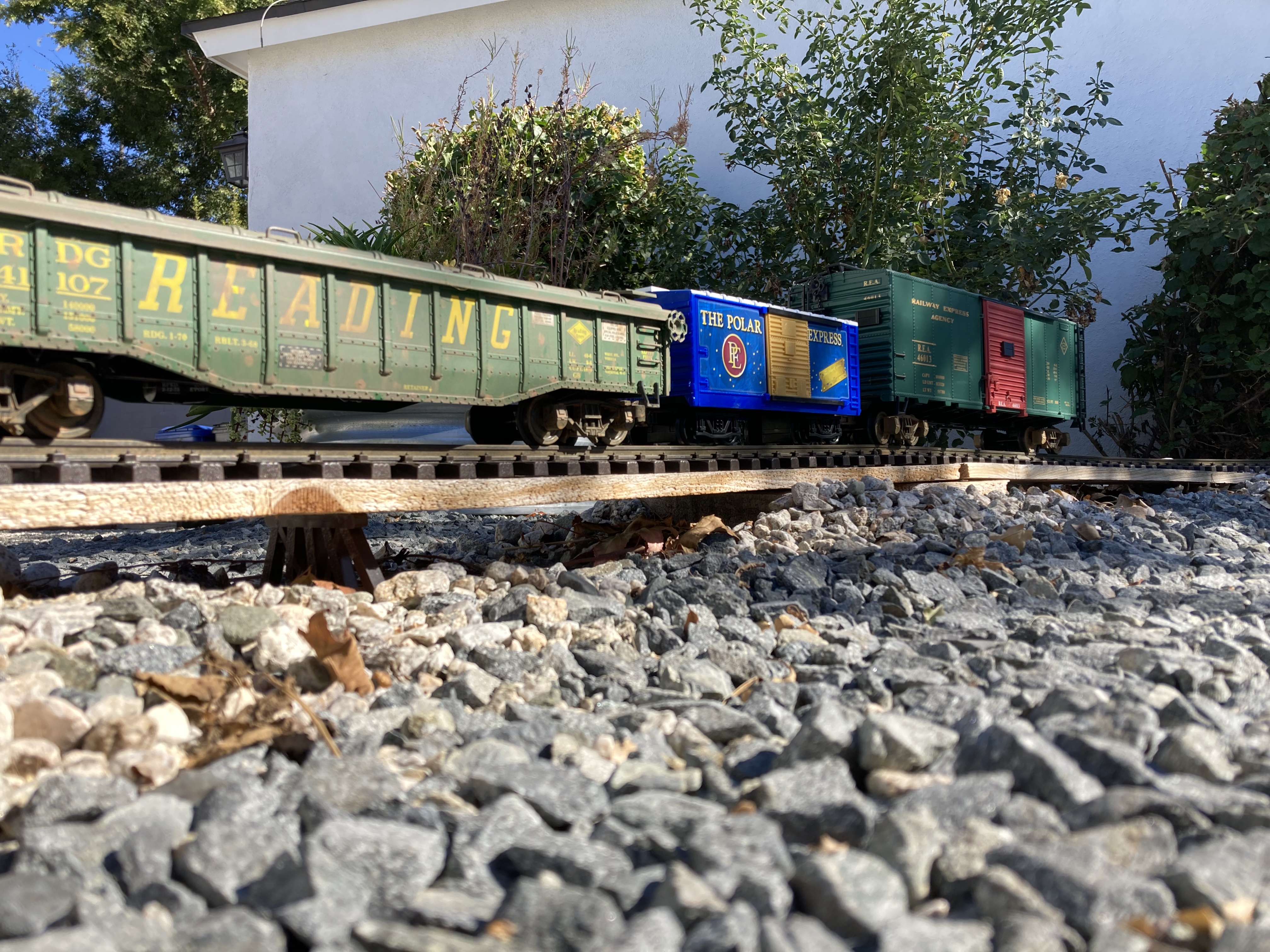

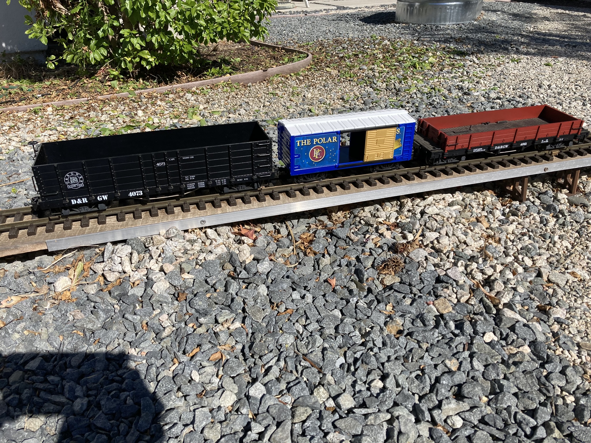

Here’s an extreme example of the size difference of G gauge cars: Aristocraft,Bachmann,LGB, and Lionel.
