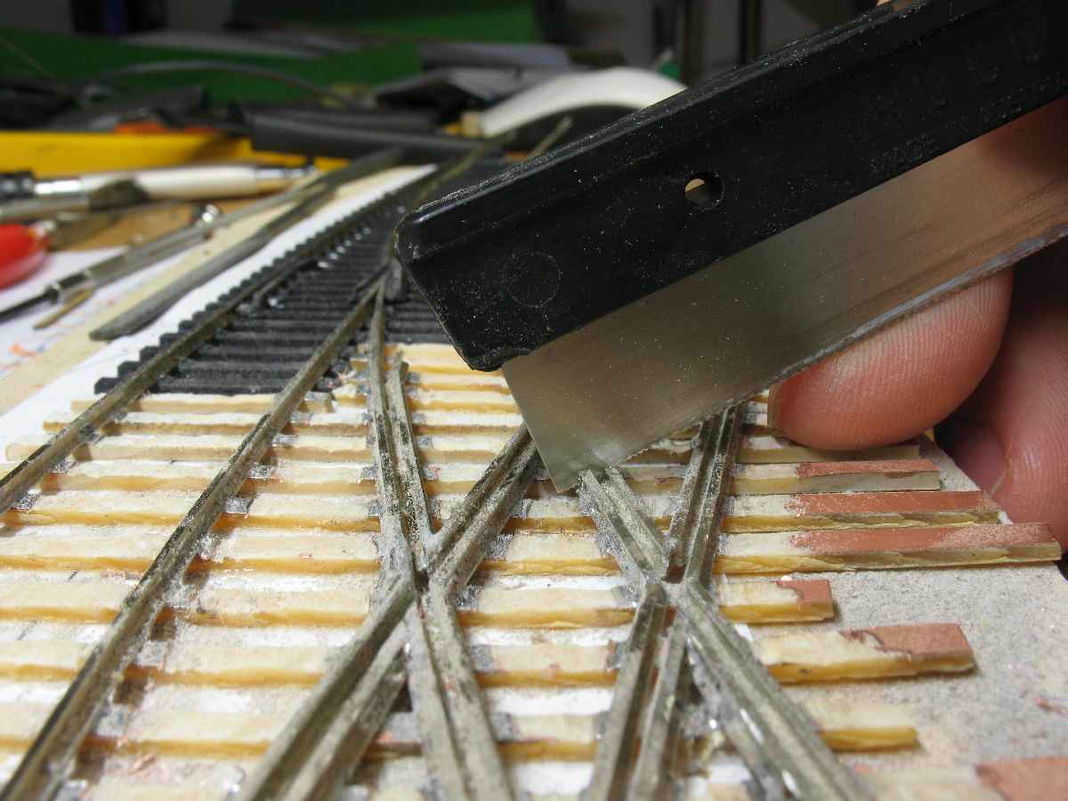

I use a fine saw. This one is from Roco.
Wolfgang
