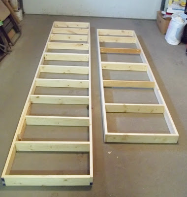

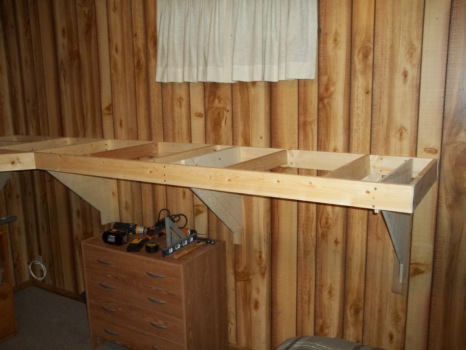

Well construction began today… all shop work. I did get the full length of the Phase 1 bench work done and part of the phase 2 bench work before I ran out of lumber. 1 x 4 construction assembled with pocket hole and screws… strong and tight! The bench top will be 1/2 inch plywood sanded one side. I still have to make the wall braces. It’s great to get this finally started!
Due to a medical condition I don’t have very good balance and usually walk with a cane. I fell and hit my forehead square on the concrete… hurts like hell and work ended at that time :slight_smile: I hope to get these sections installed and attached to the walls on Sunday… Lord Willing!

If you have much more to build, get some sawhorses so you don’t have to bend over to work on it. Bring the work to you. I don’t have those sort of problems and it’s still a huge pain to work on something that’s on the floor. There’s enough head-bashing injuries resultign from workign on the layout without adding bouncing your head off a concrete floor to the mix.
–Randy
Hi Randy, these were taken after i cleaned up the shop. I have about 4 sets of saw horses… I absolutely couldn’t work on the ground like that… you are right there!

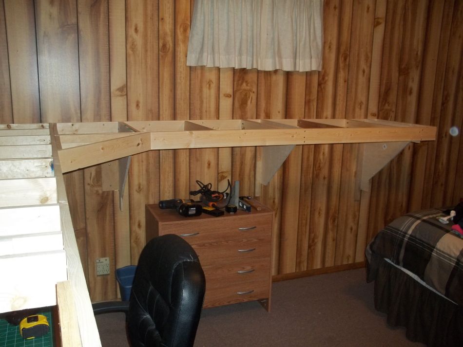

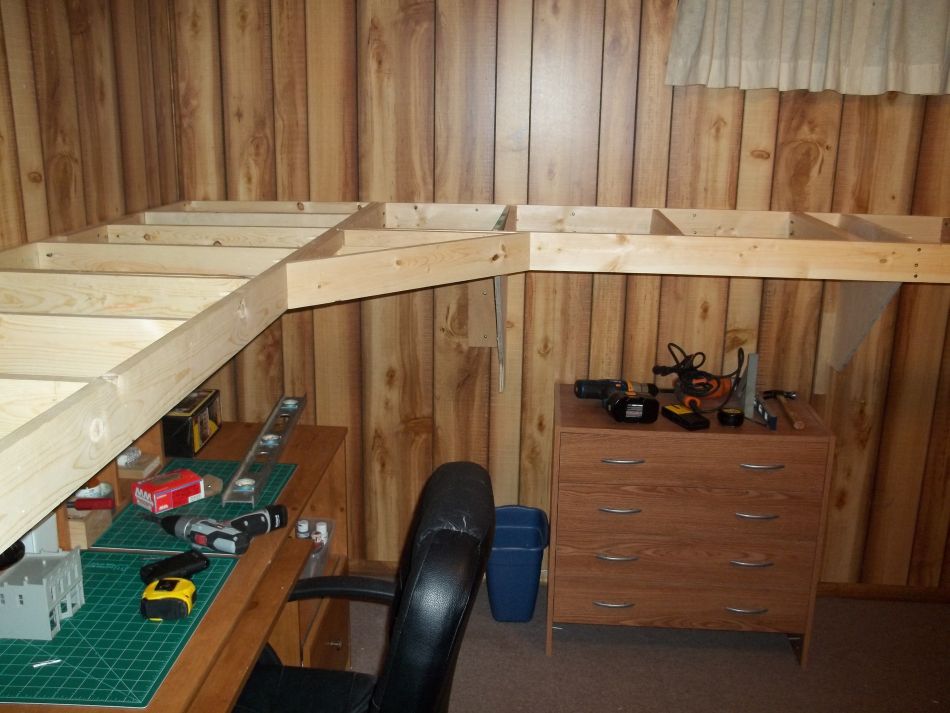

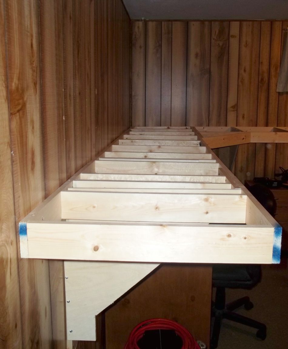

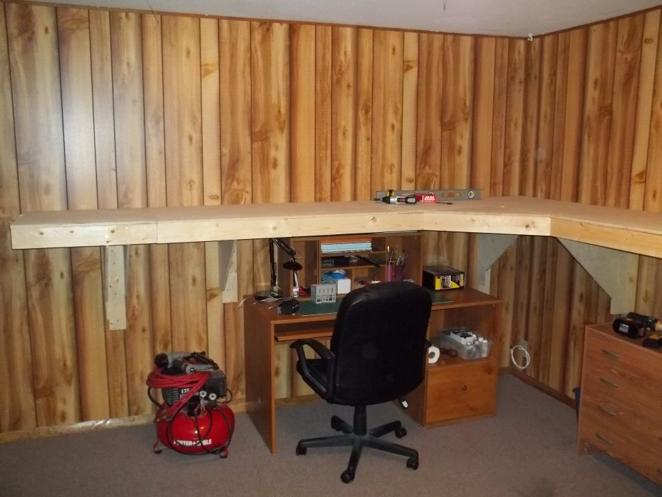

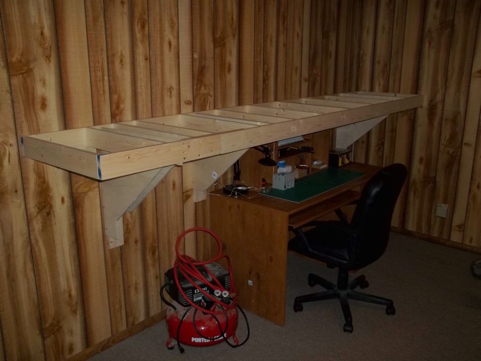

OK the first of the bench work was installed last night. This is a 2 foot by 10 foot sections. Ground Zero with the foam and plywood will be right at 51 inches. I have another 10 foot section to get installed today and to screw down the top as well. I modified an old computer desk and made it into my modeling desk. I put furniture sliders on it and it just slides right underneath with room to spare. It’s 2 foot deep as well so eventually when the layout is skirted with masonite and fabric it will not even be noticed.

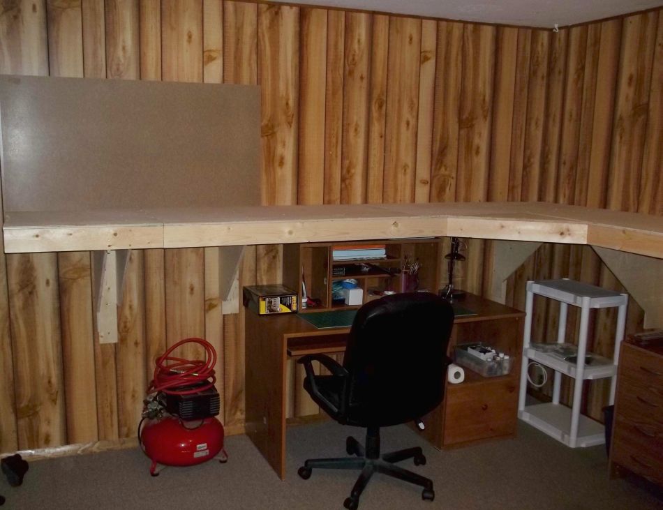

Well i got another 10 foot section of bench work installed. Still have another 4 foot for the long wall but ran out of 1 x 4’s… another day. I have plenty to keep me busy now. Plywood is fitted and ready to be screwed down tomorrow. My wife gave me the little chest… it has shallow drawers and perfect for rolling stock and locomotives.

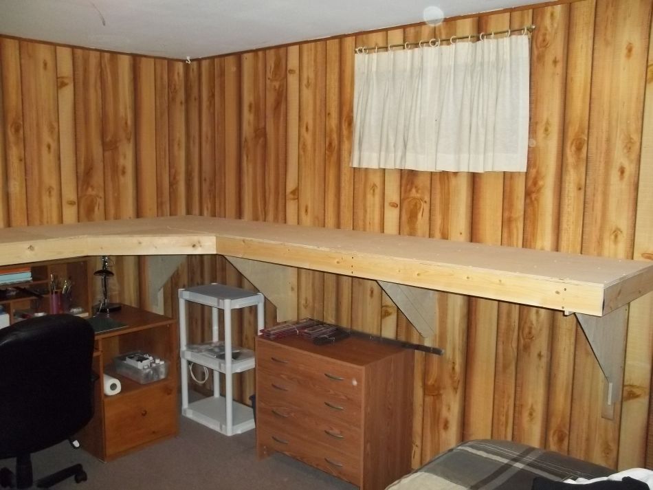

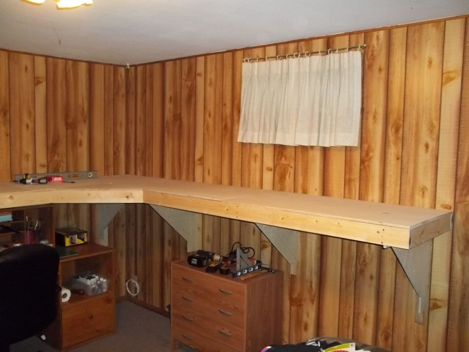

Well here is the final update for the weekend. You can’t tell a lot of difference but I did get the top screwed down and started on the back drops but thought i had more 1 x 2’s. Oh well, next weekend. Going to start working on the track layout now. Anyway, thanks for following along!

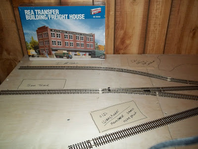

Well I worked on the trackage this weekend. I have the Phase 1 track the way I want it and most of the Phase 2 section as well. Will tweak some of that later. I will be installing some foam next, then laying my N scale cork sheets. Most of the track is yard and low profile trackage but wanted some lift so i went with the sheets of N Scale.
Thanks for looking!
The old farm implement section. I will use the Walthers REA warehouse building for the International Harvester Corp manfacuring building and the Walthers Engineering building for the office and warehouse. [![|316x400](http://3.bp.blogspot.com/-wmECN7t0vCk/TnakQ7MvE-I/AAAAAAAAAEo/ofVTy8RVWKw/s400/LayoutConst17.jpg)](http://3.bp.blogspot.com/-wmECN7t0vCk/TnakQ7MvE-I/AAAAAAAAAEo/ofVTy8RVWKw/s1600/LayoutConst17.jpg)
More of the Implement District. The middle track will be a team track and loading platform and also that is the track that the 3 foot cassette will attach to for a temporary yard while operating. The forground building will be a small warehouse that the local newspaper received and stored newsprint at.
