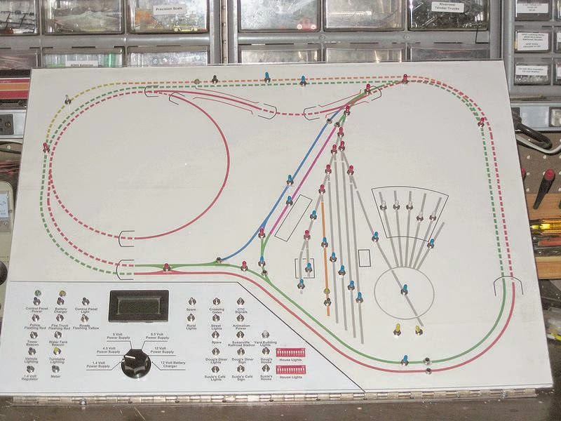

I am going to build a control panel similar to this one that Paul has talked about several times:
I like the idea of having some room to set down throttles and to store some papers under it. In searching for panel ideas I have found examples of panels with the hinges mounted on the top so it swings up and on the bottom so that it swings down.

How did you print your track layout? Is it on paper, or is it printed on some kind of more solid material?
Mine is printed on paper from my CAD program. It is printed on legal size paper total 6 panels. My panel is 18" x 24".
I’m constantly making changes to my switch panel so I print it separately, 2 panels.
I tack the drawings to the Aluminum base panel using rubber glue then sandwich it with the Plexiglas top panel.
Lots of hole drilling.

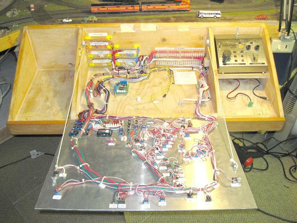

When I built the panels for the club it seemed to make sense to have them hinged at the bottom so that when they were opened everything was easily reached. However, I don’t think it makes a huge difference where the hinges are. It is more important IMHO to arrange the wiring so that the wires leading to the layout don’t cross over the wires in the panel. In other words, if the hinges are at the bottom then the wiring leading to the layout should exit the control panel from the bottom. When the panel folds down, the wire exit point is closest to the layout.
Here is the back of one of the temporary panels. The LED indicators have not been installed yet. We used masonite initially until the wiring design and switch locations were finalized:
The tags shown above were not installed until after the panel was in place and had been tested. The temporary panels could be adjusted relatively easily if adjustments were made to the track plan, of which there were several. Another advantage of using temporary panels is that you will quickly identify any mistakes, of which there were a couple.
