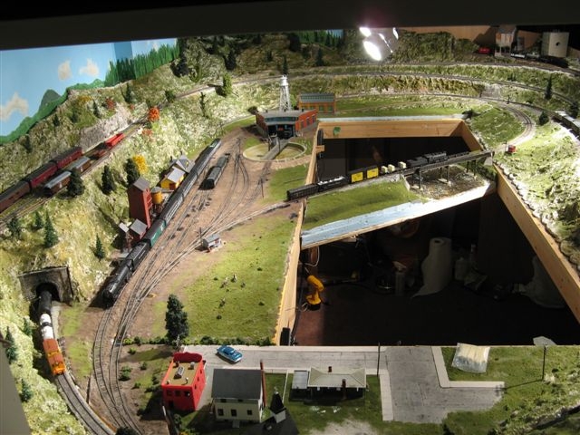

Dan, I agree heartily. I decided when planning my second (current) layout that being surrounded by the entire scenery and tracks would be a experience in immersion. It was also a most sensible use of the same space. The only drawback is that it requires a gate or duckunder…no big deal in my case; I am short and still young. I think this is the ideal for many of us. I don’t misunderstand and fail to appreciate the obvious sense and appeal of around the wall, very likely my next design, but for now this is it.
In this image, the central pit is 36" across and 92" long…room for two realistically, three in a controlled pinch.
