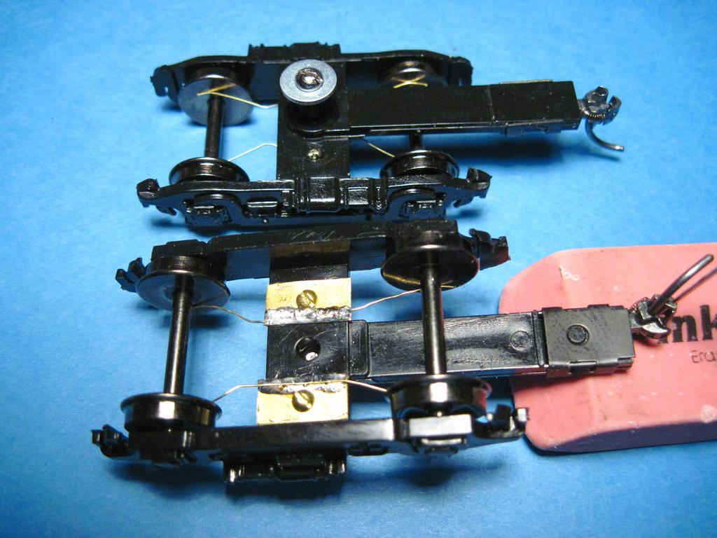

Hi Mel,
Thanks for you thoughts and experience. Could you, please, add a photo of the underside of the two Daylights you show? Are these are the ones with the shelf couplers?
-GN goat kid
These Athearn trucks have Kadee Scale Shelf Couplers.
They fit my Athearn Daylight passenger cars.
The pictures were taken in 2016 when I was overhauling my Daylight lighting. The power pickup is not for the lighting, I have a DCC decoder (Digitrax FL1) in the observation car to control the backup light.
