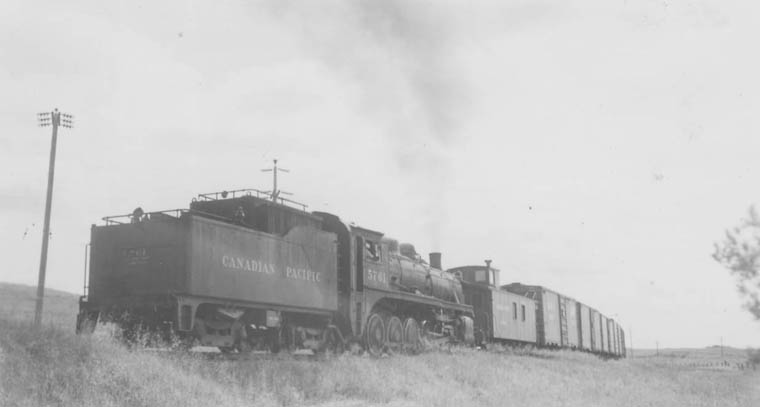

CPR Decapod with a very weird light on smokebox.
What in the blazes is this forward facing light on this CPR Decapod?
Visible in 3rd picture.
Does it have something to do with it’s assignment as a pusher?
Rear facing light on tender is CPR standard, but very old style, common on smaller older steam.
Two views of 5761 assisting on the rear of a freight leaving Minnedosa, Manitoba. July 4,1955
L.A.Stuckey/Bruce Chapman Collection
While many people think of the prairies as being flat that is not the truth. There were many places requring assist engines to help freight trains up grades in the steam era. Minnedosa was in a saucer, requiring helpers in both directions.
Last R3b 5762 CPR January 1918. Yard service Moose Jaw Tuesday, September 8, 1959 Robert Trennert
Apparently the tender has been incorrectly stencilled at only 1850 gallons of oil rather than the official 2800 gallons.
Water 7800 gallons.

They might have broken the headlight and be waiting for the proper replacement.
Peter
Thanks for that Peter. I thought perhaps it was a holdover from war time black out restrictions. However, I found this caption accompanying the exact same photo and it states " reducing glare". Now I speak English and know what ‘reducing glare’ means but in this context I do not know what it means. Is it because of its pusher assignment or yard duties and why would there be glare in doing this?
Here is 5761 some years later equipped for yard service with footboards, special headlight to reduce glare and small tender.
Revelstoke 9/1951 Bruce Chapman Collection
Perhaps it was to reduce glare into the caboose that would be immediately in front of the pusher.
Yeah that’s the obvious logical answer but then why only this one particular locomotive and not something we see on all pushers everywhere? Also it’s a very weird looking light, sticking way out and so tiny with a weird shape. It almost looks like a modern day LED array in a compact housing but that’s impossible.

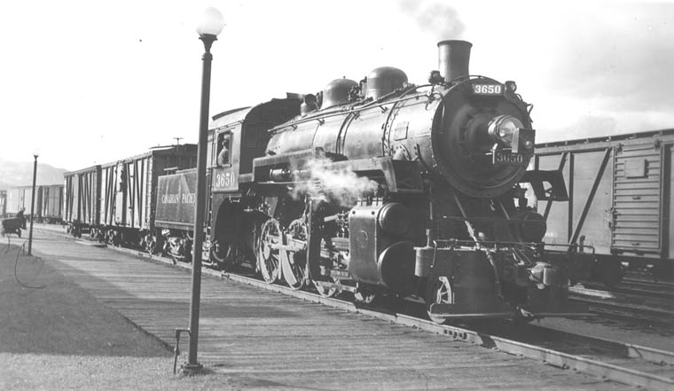

Note the tiny yard headlight designed to counter visibility problems for yardmen due to fog in Vancouver. See also 3449.
Drake Street Vancouver September 28, 1941 Bud Laws Collection
M4e 3449 one of ten engines (3441-3450) built by CPR Angus Shops. #1465 6/1906
Cylinders 22 1/2" x 28" boiler pressure 180 pounds per square inch. Tractive effort 37,400 pounds (36%).
Note the unique headlight designed to counter visibility problems for yardmen due to fog in Vancouver

Headlight… More.
http://www.trainweb.org/oldtimetrains/photos/cpr_steam/3650a.jpg
http://www.trainweb.org/oldtimetrains/photos/cpr_steam/3650b.jpg

Nice work NDG ,more questions, nothing solved however. Two photos show the light scewed off to the side and all show the light in addition to the traditional smokebox centered light. These lights must have produced a very concentrated narrow beam. Strange looking though.
Put it all together so far and we get 1) used in switching 2) less glare 3) good in fog 4) blackout conditions 5) courtesy to caboose when pushing 6) possibly used for measurement …( communication with mother ship? so maybe still an X-File )
Interesting to compare this with the special ‘fog light’ on the PRR T1s (the purpose of which is still not well established by the T1 Trust).
I suspect the issue of ‘glare’ might be more important to the yard or other workers facing the locomotive than back reflection to the operating crew. Otherwise why retain the full headlight for tender-first moves…
I notice that most of the pictures showing different positions of these lights all seem to be dated in the early wartime period (1941-42) which to me strongly enhances the idea that some of this is blackout lighting. On the other hand the absence of hoods or visors for the small lens would not jibe with that.
Be interesting to see a color picture (or find out from someone who ran them) to see if the light were an unusual color, like yellow.
