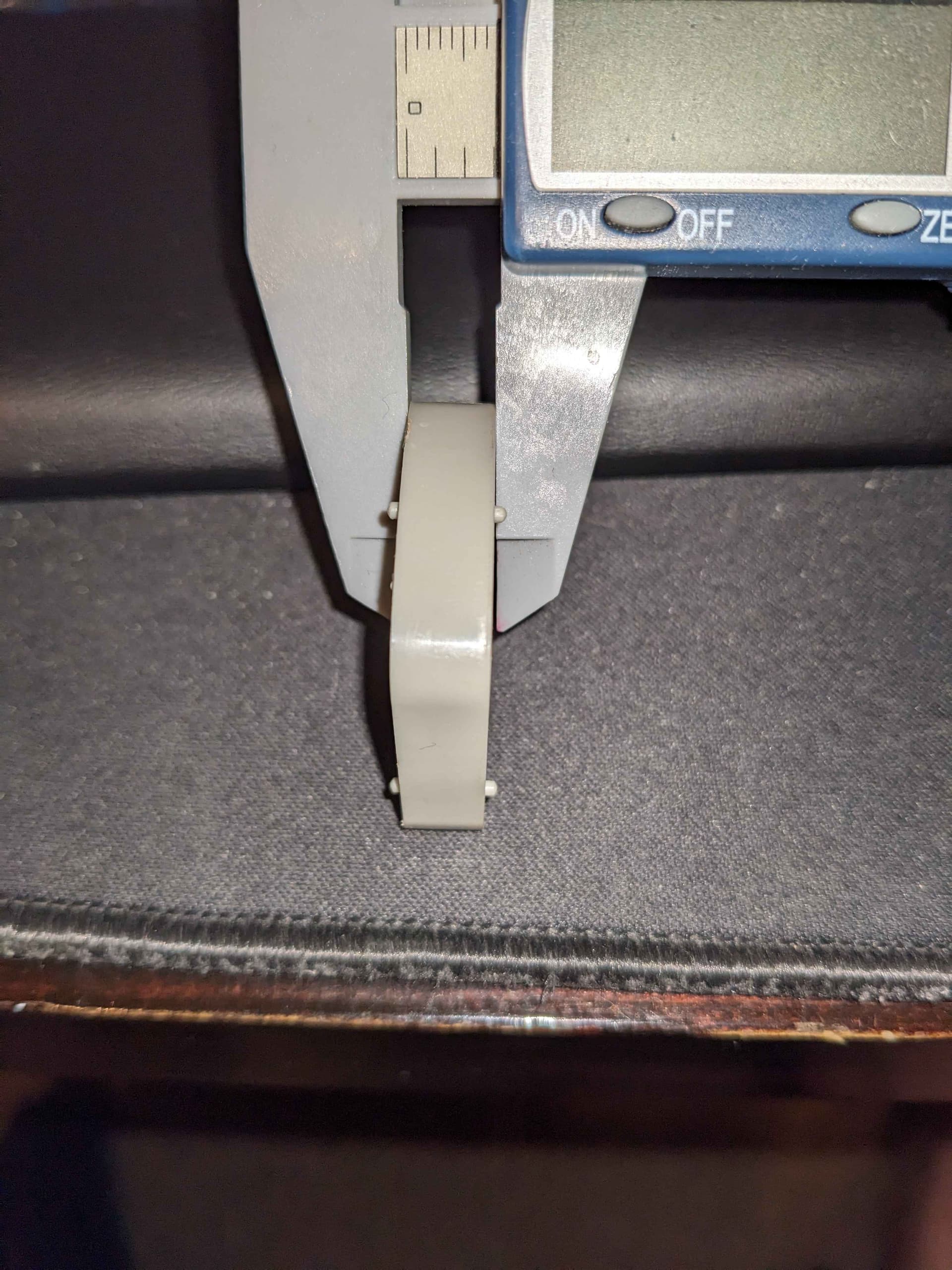

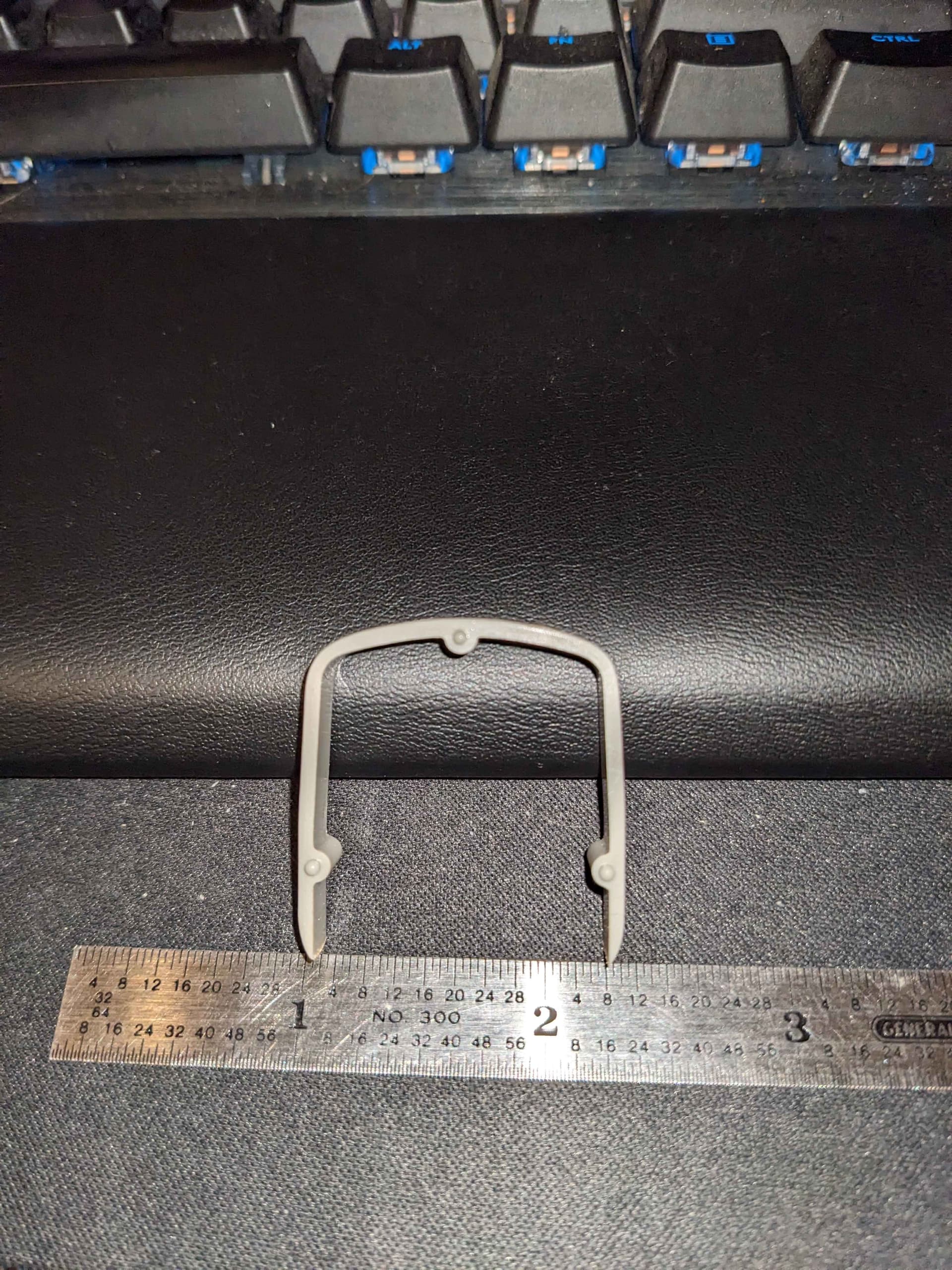

Did you happen to model the U-shaped piece that goes between cars? I’ve been looking everywhere for a model of it!

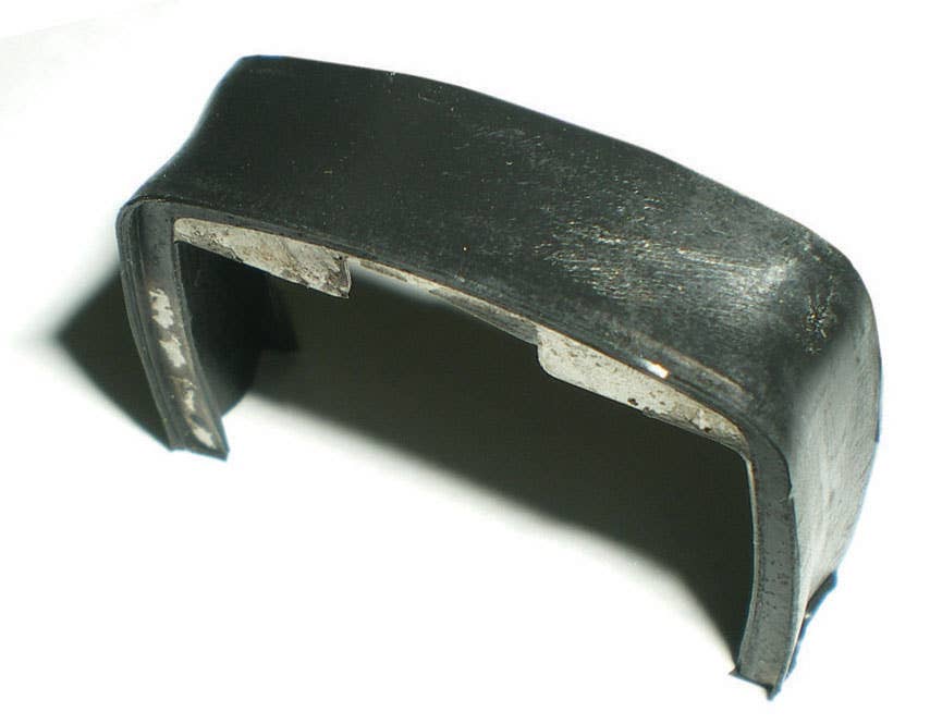

I wonder how close the profile is to the diaphragms used on the Rapido TurboTrain?
They are made in both short or long versions.
Good Luck, Ed
I haven’t designed that, but if you can let me know what the depth of it is (my Bowser set didn’t include them), I should be able to make a 3D model pretty quickly.
Dude, that would be awesome!
It’s about 8 mm not including the little bumps. This is for a friends dad’s set, it only had one and was supposed to have 2

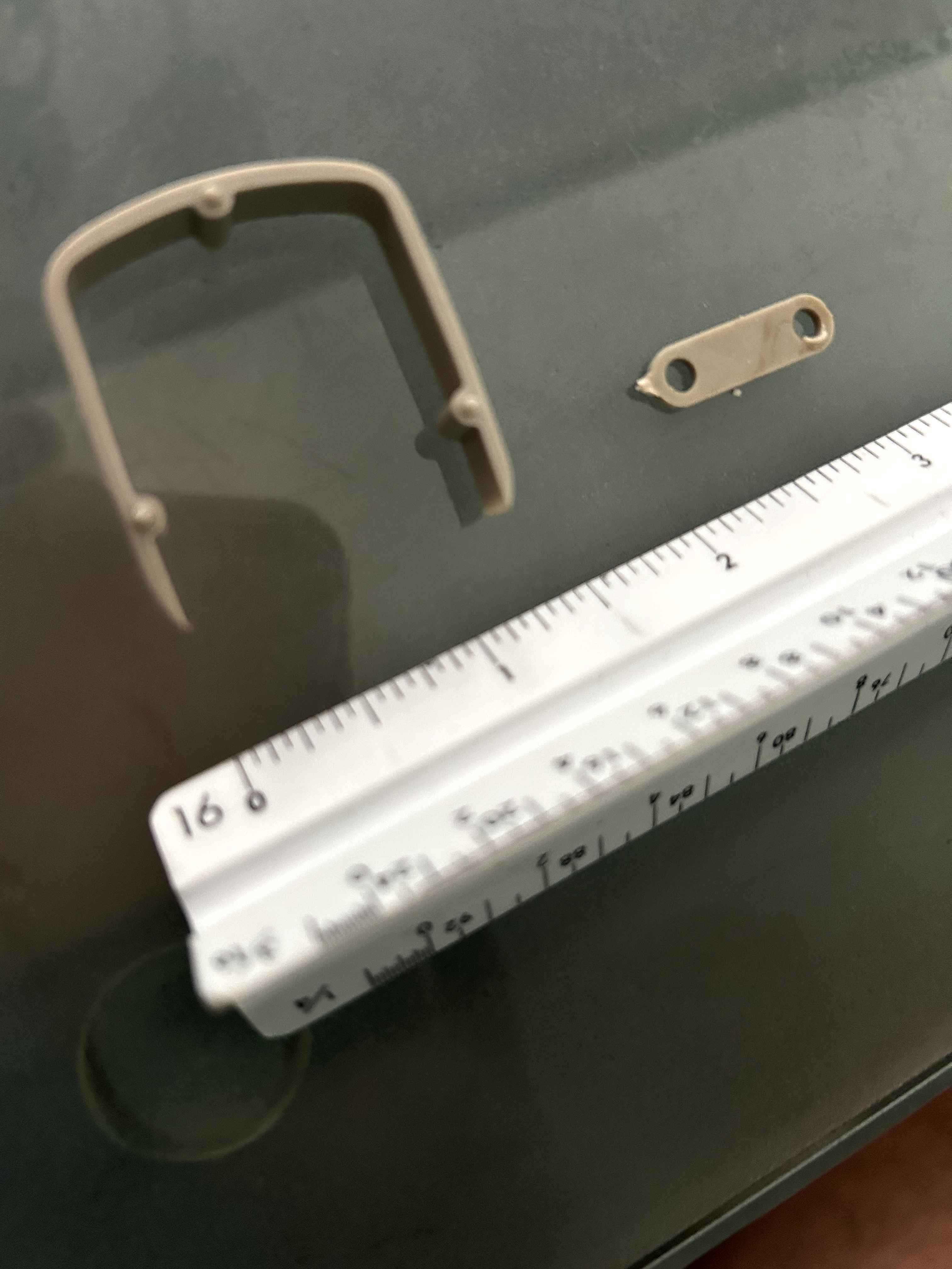

Another picture:
Very generous of you, Darth. :+1:
Thanks for the measurements! I added it to the files on the Aerotrain interior page: https://www.thingiverse.com/thing:4716983/files
I haven’t tested the print, but I took measurements directly from one of my passenger cars, so it should fit! Also, based on the dimensions and the fact that there are tabs at both ends, I’m guessing that these were meant for display use only, so the set might not go around a turn.
