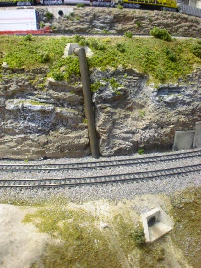

I have a number of culverts on my layout, some in finished scenes, others not. Maybe these will supply some ideas.
This concrete box culvert was built from styrene sheet and Evergreen C channel.
The culvert at right under the track was made from soda straws, while the one under the dirt road used the corrugated portions of other straws (the smooth parts were buried).
This one has home-made plaster castings of WP prototypes, but could also have used commercial parts or have been scratched from styrene.
This is a larger version of the plaster castings used above. It’s actually see-through if you get low enough, and has a styrene box separating the castings on either side.

Since you have a stone wall and pending your era, you could use a stone culvert. If a later era, the culvert can show recent upgrades/ reworking to concrete as shown.

Great modelling including the culverts! The dirt road going over the tracks and into the background is superb!
Dave
Thanks, Dave! [swg]
Different diameters of PVC can be cut and painted. The slurry looking water was made with Scotch tape with ModPodge brushed on in layers. The water can be lightly tinted to give it a brackish appearance.
