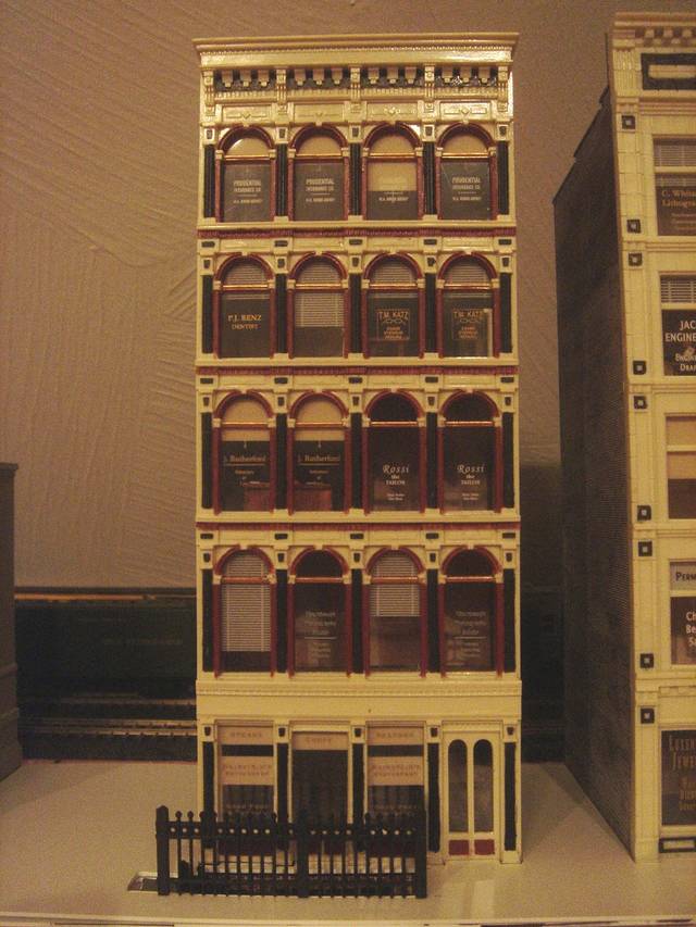

I built the same kit. For window shades, I used the pre-made sheets from City Classics. This is an interior view of one room. I used the Venetian blinds, pre-printed on clear acetate so all you do is cut them to size and glue them in:
I did do interiors in these rooms. They’re just printed on the computer, and again, cut to size and glued in. I made the interior walls with foamboard. This is a nighttime shot from the front:
Some rooms have blinds, and others have pull-down shades. with either of these, visibility into the room is greatly restricted, so just putting in an image of a rug is enough to provide a “detailed” interior.
This is the City Classics “Grant Street Building” kit, I believe. Here, I “doubled down” on some of the windows, with the pre-made windows with signs and then blinds or shades behind them.
