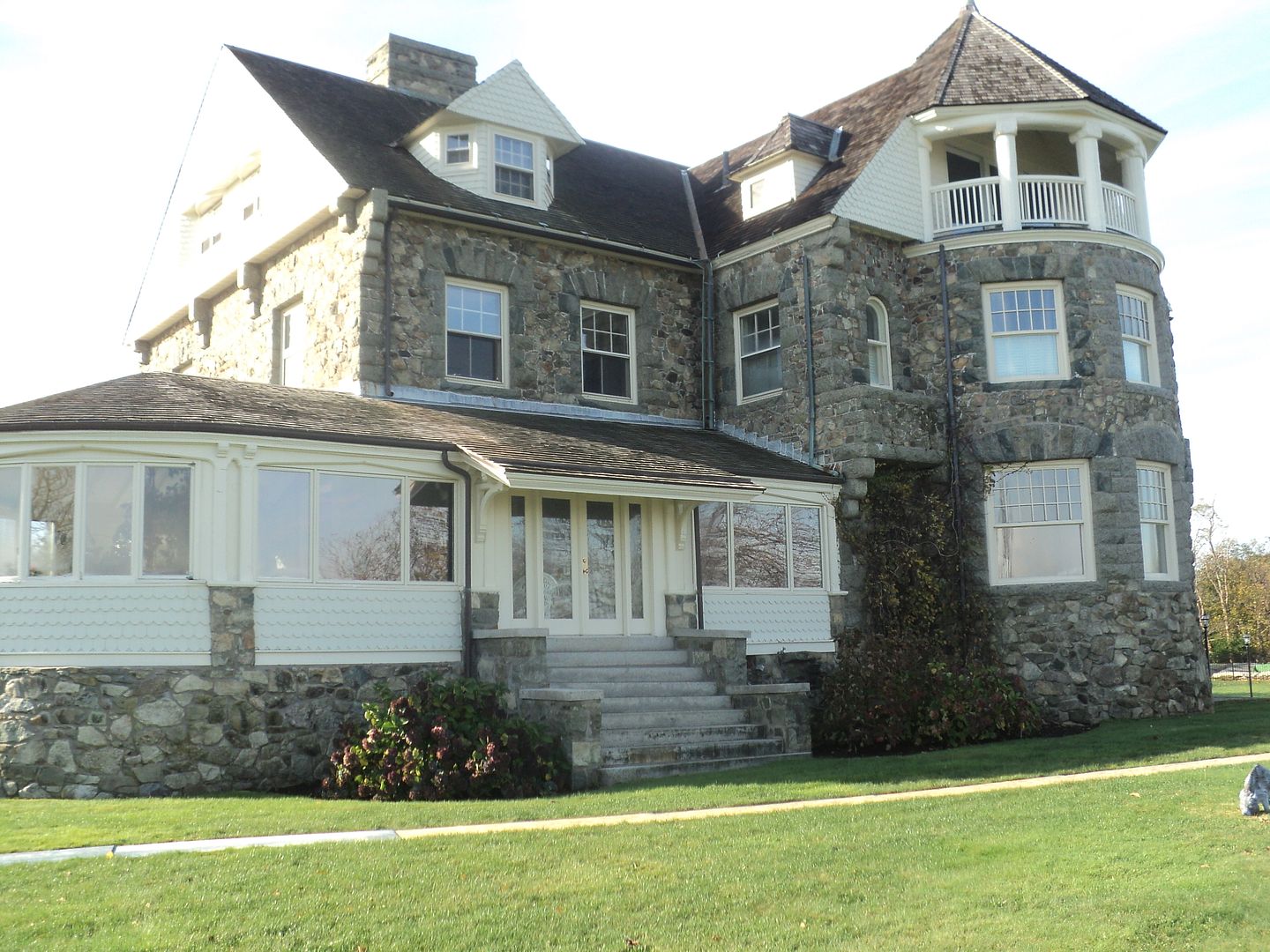

So true, most round applications have flat window sash but w/ modified head jamb and sill to the curvature. The extreme cost of milled curved sash and curved glass lend these to only be used in rather expensive custom installations. One replacement window job in a rather affluent beach area required custom ordering of the 6 curved double hung windows in the stone turret. Very few specialty companies will mill these and fit the glass. each window was more than 10x the cost of even the high quality “flat” version.
Always been a favorite of mine for years, now I have a chance to keep it looking perfect
