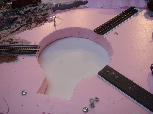

Something else to consider. Does your TT require access from the bottom for wiring or service?
This is what I did for mine:
This is 2-inch foam, with a piece of masonite for the base. You can see the 4 carriage bolts I used to hold the masonite in place. Once the scenery and the lead and roundhouse tracks are in place, the only way this turntable will ever come out is from below, so I made the base removeable from underneath.
If you really want only a 1-inch deep hole, you could do something like this and then put a 1-inch piece inside the hole, supported by the masonite base. Or, you could get a larger sheet of 1-inch foam and replace the 2-inch foam in the area around the turntable, so you’d only be cutting through 1 inch. For a small area, 1-inch foam should still be stiff enough if you can put some support close by.
I did the cut with a dry-wall saw, by the way. It made a mess, but it was very easy and worked great.
