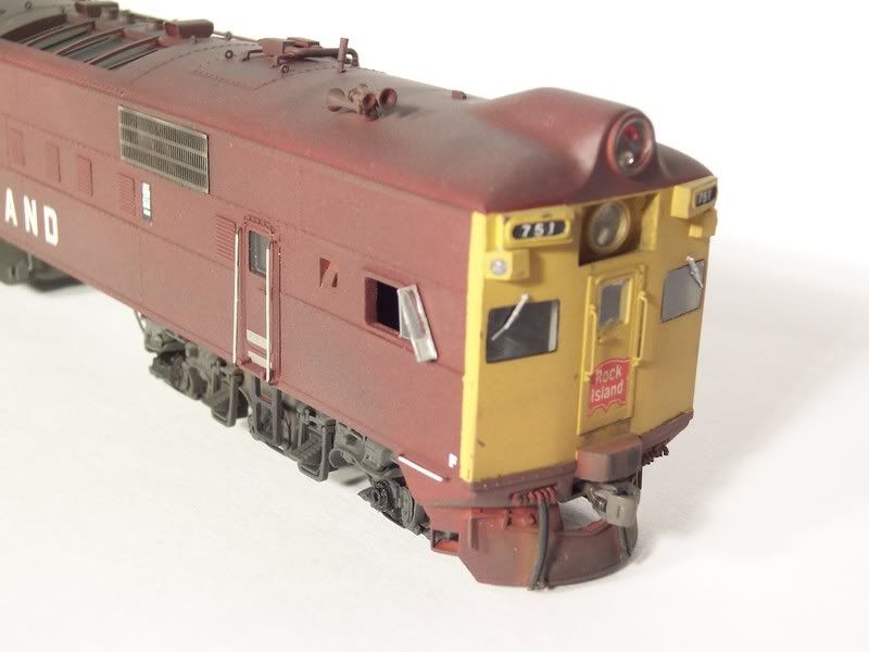

Very nice work on that RI unit.
How does the windshield and door glass come out? Do not see any glue marks. May be easier to mask. And the red nose may be more easily decaled than masked.
Figured out the porthole glazing and the metal grill appears to be spot CA glued. The handrails and eyebrow grabs have been heat set but they’re easily painted.
