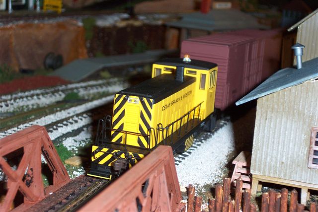

I recall that someone posted this question earlier, but never received a definitive answer. Is it possible to install a decoder and use its motor control features in the older Bachmann Spectrum 70 and 44 tonners which contain the two separate motors? It was common for one of the motors to hang up when starting up the locomotive at low speed. Has anyone tried it?
I have both the older, two motor version and the newer, single motor version of both the 44 and 70 tonners. My older, dual motor models were tweaked and ran very well compared to some of the new single motor productions. I’d like to put them back into operation.
