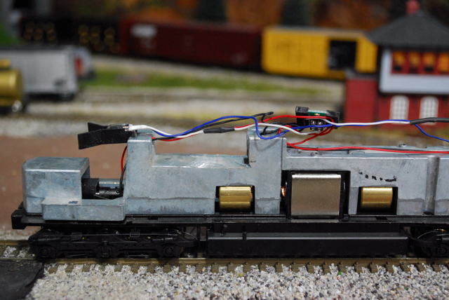

Ditto. I’ve got 2 P2K GP60s and I went with the DH165L0 decoders. Pretty much drop in and move the number board light to a function, no real room for a speaker. On the other hand I am finishing up 6 - P2K SD50/60/60M upgrades with DH165L0s and have added the Soundbug chips. It has required milling off a small portion of the weight to make room for a 16x35mm speaker enclosure.
nice pict. Jeff,nothing says it better than a pict. then one can see how it all comes together…ps you say you milled the wieght for speaker did you cut with a small cutoff wheel or did you actully use a mill ? I ask cause I cut a wight in a G scale tender once and remember it was not easy got hot quick time and took much longer than one would think…Jerry
A cutoff wheel and a hacksaw. I actually turn the locmotive upside down and clamp the back part in a vise. That way I don’t have to disassemble the locomotive and the dust from cutting all falls into the trashcan below. Here’s a couple more pictures:
Here you can see the cut marks.
Here is with the lead chunk removed.
Here’s the assembled decoder, Soundbug and speaker enclosure.
thanks Jeff ,now I m green, so you got the board style decoder and the sound bug attaches to it but you did’nt use the stock speaker that came with the sound bug …correct me if wrong …good idea about turnig over to cut… hows the sound volume to you ,some say volume to low on sound bug? … thanks again Jerry (green)
I use a 16x35mm speaker and enclosure. You can get them from Tony’s or Litchfield station. The volume isn’t bad but you do need to crank it up more than the QSI decoders. I set CV58 to 12-14 to adjust the master volume louder.
