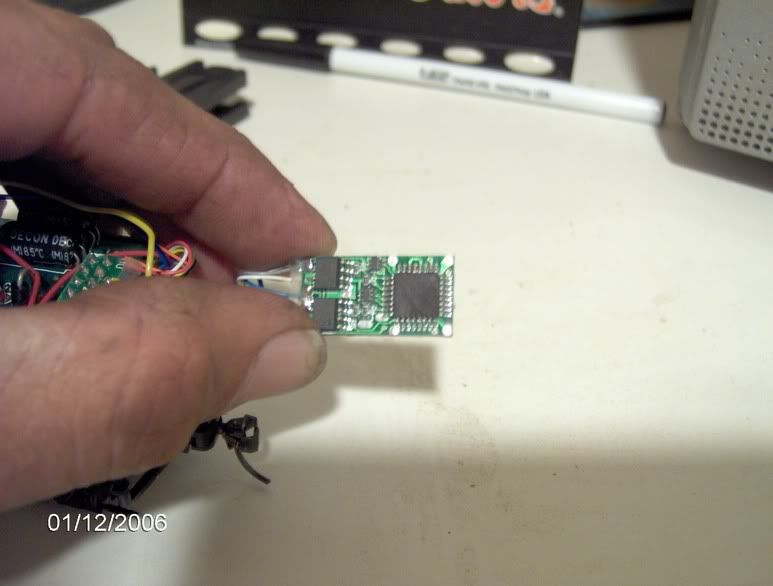

Does anyone know what decoder should go into a Roundhouse EMD Model 40 Diesel which is HO scale and DCC ready? I’ve sent two e-mails to Tony’s train house 3-5 weeks apart asking them, and received no response. I’ve got this sneaky feeling that there is no decoder for this unit as of yet.[?]
Why not go with one of the generics?? TCS for example… If space is a concern, try one of the Lenz N scale decoders… Niether are drop in installs but they’ll get you up and running…

Do you want sound, too or just motor control? If you want motor control only, TCS makes some mighty tiny ones. I’ve never used um, but I hear they’re good. I usually just use Digitrax.
The TCS web site shows exactly how to use one of their M series decoders - including the fix for the bad wiring which is left uncorrected will blow the function outputs on the decoder as soon as you try to turn on the lights. Tight fit but it can be done.

You’d have to trace the leads on the circuit board to the diodes. I don’t know if they EVER corrected it, even in the second run with different road names. The thing to keep in mind is that the BLUE wire from the DCC decoder is plus, the white and yellow are minus. The fault is that there is a diode wired to be a dead short across the decoder function output. If the banded end of the diode connects to the white or yellow lead, and the other end to the blue lead, with no resistors of any sort - no good.

John Forsythe of TSC sent me a link with all the info on how it was wired wrong. There is a Diode that has been installed incorrectly also. There is a detailed page with all the info and pictures on how to correct this. I don’t know, I kind of think that this is something that MR should pick up on their issues. A trouble shooting article on defects put out by manufactures and how to fix them. At least the hobbyist would know of the defect and would not be frustrated with something that did not work as advertised.
Here’s the link on the “Critter” fix: http://www.tcsdcc.com/decoderpics/roundhouse_Critter.htm
