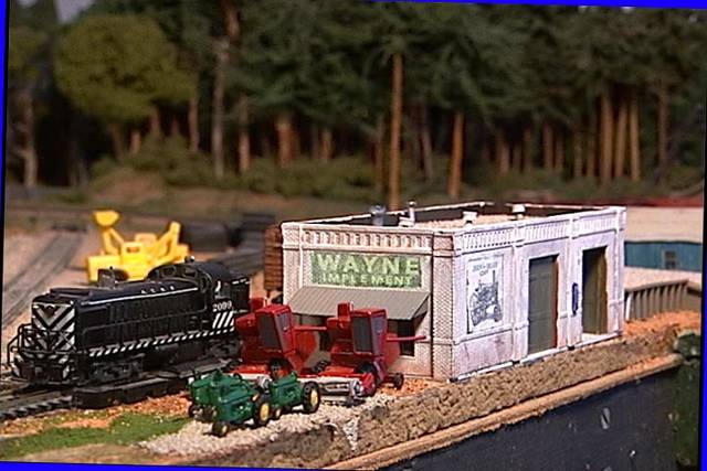

Assembled the Feed and implement dealer not quite to directions to make it a little longer.

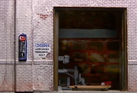

The door was built into a wall section but I carefully cut it out to model it open.

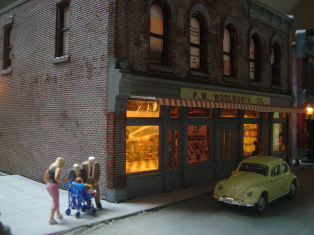

I think they’re great. This is one of my earlier ones:
The brick detail is really very nice. This is one of those where all the window trim is molded with the walls, so there are very few parts to assemble. Take your time and use a very small brush to paint them. I use cheap acrylics, so I can just use a damp paper towel to wipe off any mistakes right away.
I do my brick mortar with Hydrocal on these, after I paint the basic color, but before I paint the window trim.
As someone else mentioned, the walls don’t come out square. The edges are bevelled so that they come out of the forms easily when they make these, so squaring them off is part of putting the kit together. I’ve also found that the back wall on many of these is as much as a quarter-inch too wide, so the kit doesn’t assemble square at all. I cut the wall to size after I’ve got all the edges squared off. Watch for this - it’s probably not the case on all the kits.
Finally, details really help. The buildings don’t come with signs or decals, but they’re easy enough to make yourself, and add a lot to each structure. The roof will probably be a plain sheet of white styrene that you’ll have to cut to size. I use small balsa strips inside the building to make a strip around the walls for the roof to set on. That also blocks light from leaking up around the edges of the roof.

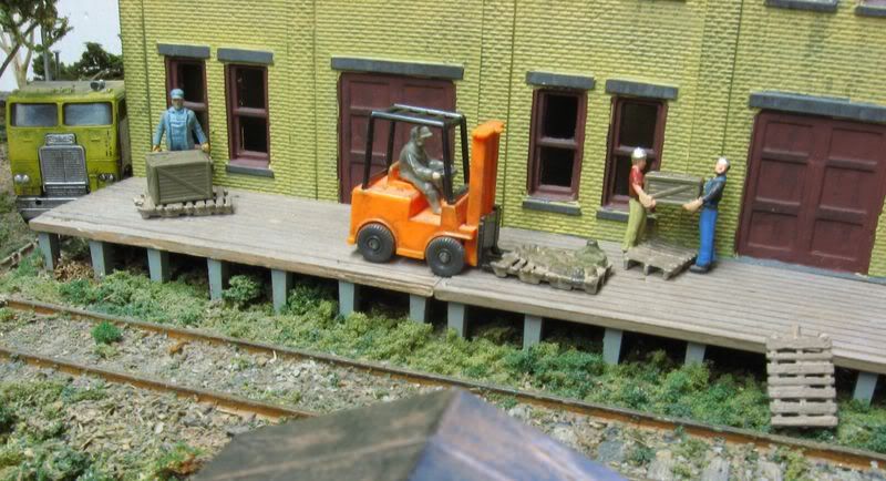

This is a pair of townhouses:
Again, the kits were 4 walls and a roof. They also included some clear plastic window glazing material. I jacked the buildings up on a foundataion, and added the concrete stoops out front. I used tissue paper for window shades. (The tissue paper was in the kit, used to protect the window glazing from scratches.) The fence is Atlas hairpin fencing, and the figures (Tom and Aretha in the background, Carl and Lenny up front) are from Preiser.
