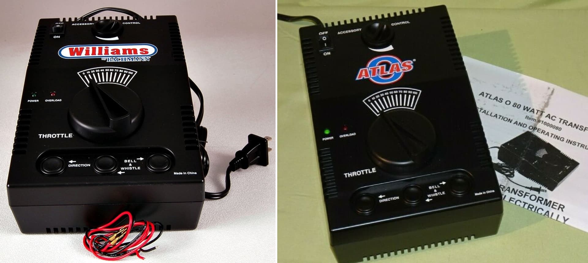

To be honest, though, a lot of this feels like re-inventing the wheel…a lot of inexpensive trains have gone to fixed track voltage with onboard remote motor controllers because it’s cheaper to do it that way now than to build a true variable voltage transformer.
