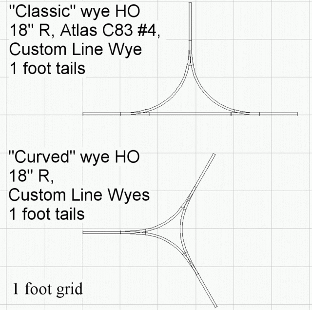

I am thinking about adding a wye to one end of my HO railroad instead of a turntable. I have relatively small steam engines 4-6-0, 2-8-0. etc so I am thinking about #4 turnouts and 18 inch radius. My question is if anyone has build such a wye, how much space did it take? What were the dimensions of your wye? Mine would have to extend into the room where it might interfere with my exercise equipment. Thanks - Nevin
In the classic “wye” shape, it would protrude about 3 feet into the room, as seen here with a 1-foot-long “tail” beyond each turnout. Different turnouts would change the dimensions a bit.
If your equipment is shorter, you could decrease the length of the tail … you just need clearance beyond the points for your longest engine.
Keep in mind that you can bend a wye around a turnback curve or even make a “scissors” version with a crossing to change the overall shape a bit. Although for your prototype, simpler is probably better.
Byron

The curved wye can be a bit more compact overall, but may not fit as well in the narrow shelf style of layout that the original poster was building (if I recall correctly). It could fit well, as mentioned, around a curve in the main track.
Byron

Those drawings are exactly what I needed. My layout is a 16 inch wide shelf so there is no way I can fit it into the corner. I can extend into the room and it looks like the minimum extension length is about 3 feet. It definitely could work. - Nevin
