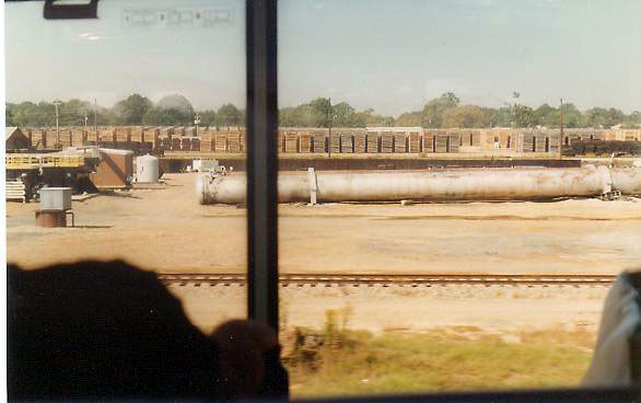

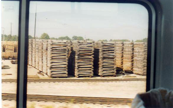

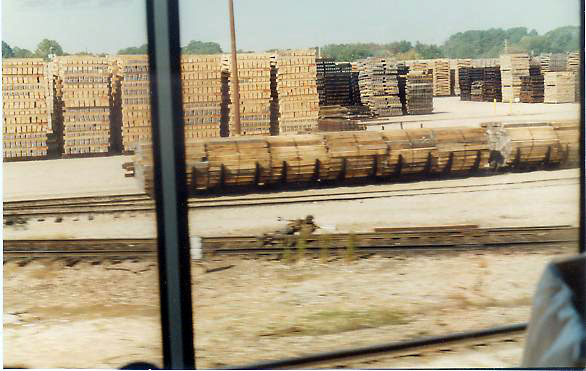

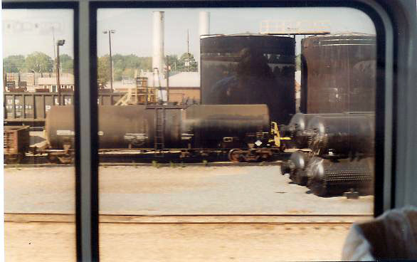

When I traveled on the Amtrak Texas Eagle from San Antonio to St. Louis and back in 1996, we passed a big tie plant just southwest of Texarkana, maybe a mile or two from the Texarkana station, and I shot pix from the Amtrak highlevel coach.
Retort in which which wood is treated with high-pressure preservative:

Note the stacking of “green” wood ties being seasoned before treatment. A small space is left between tie to allow air to circulate so they can dry out and absorb more preservative.
Tanks for holding preservative material and a tankcar delivered…
Gondolas for shipping out ties

Nice pics, they’re a good depiction of what goes on. The raw ties are stacked so they dry, then are brought to the retort (I think that’s the term) via the tram carts, treated, then stacked for shipment in another part of the plant’s yard.

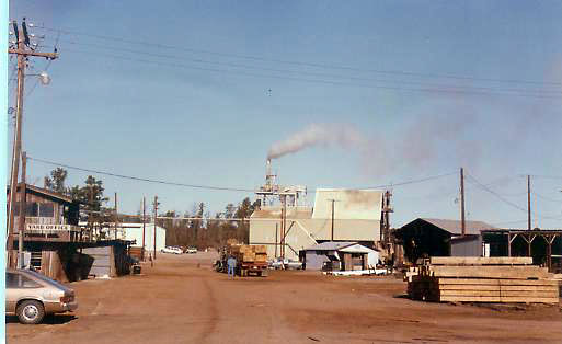

Conroe Creosoting had a plant at Conroe in the piney woods of East Texas. They graciously alloowed me to visit and shoot a few photos in 1980 or so. The plant is now gone, cleaned up. It was across the road, Texas 105, from the Santa Fe line. A spur crossed the road and came into the plant through a gate.
They preserved ties, utility poles, barn poles, fence posts. Sold to the public at a store adjacent to the highway and the plant. I got a sales brochure which listed their products as “Black Diamond” brand, I assume for the manufacturer of the preservative. Some 10 years after I visited the plant, I was making local TV commercials in Corpus Christi, we made a spot ad for a lumberyard and building supply store at Gregory, 12 miles outside CC, which featured “Black Diamond” brand preserved wood from Conroe.
General vioew of the plant. They started with raw logs, cut ties and posts and beams, etc and then preserved them so a sawmill was part of the on-site process there.
