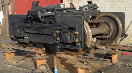

Hi, the early GE45 tonner has side rods connecting the front and rear wheels on each truck due to having only one traction motor on one axle per truck. I believe later models used a chain drive to connect the wheels. This allowed all 4 axles to be used for pulling as most 4 axle have diesel locomotives have a traction motor on each axle.
Here’s a picture from McHugh that shows how the chain drive trucks look
There are a number of reasons why this idea was used – traction motors were expensive, and do not ‘do well’ geared directly to more than one axle (unless you enjoy regularly Lidgerwooding your wheels to keep them at common diameters!). The rods are a cheap way to drive additional axles with ‘steam era’ maintenance, and permit the use of one larger motor in place of two (or economize further if you want to use gearmotors for better slow-speed performance)
The English locomotives use one relatively big motor in a ‘safe’ location away from dirt and weather (but close to the generator, without the need for flexible leads hanging down under the chassis) and relatively cheap rods and bearings that steam shedmen understood. There are some dynamics issues involved with keeping the motor mass relatively high up in the chassis, too. A couple of representative builders were English Electric and Bagnall’s.
