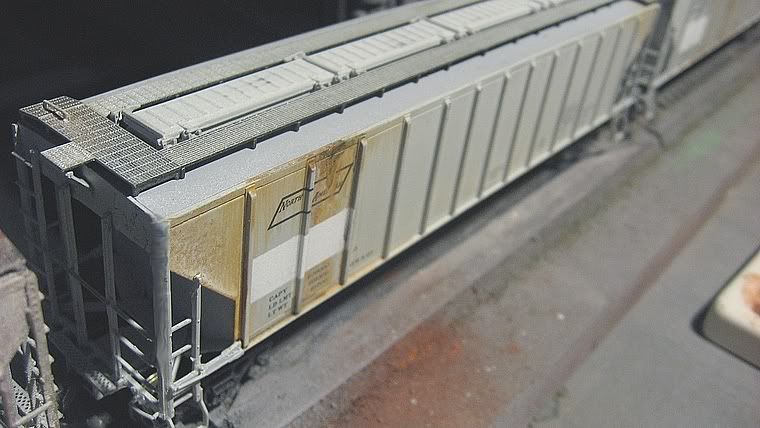

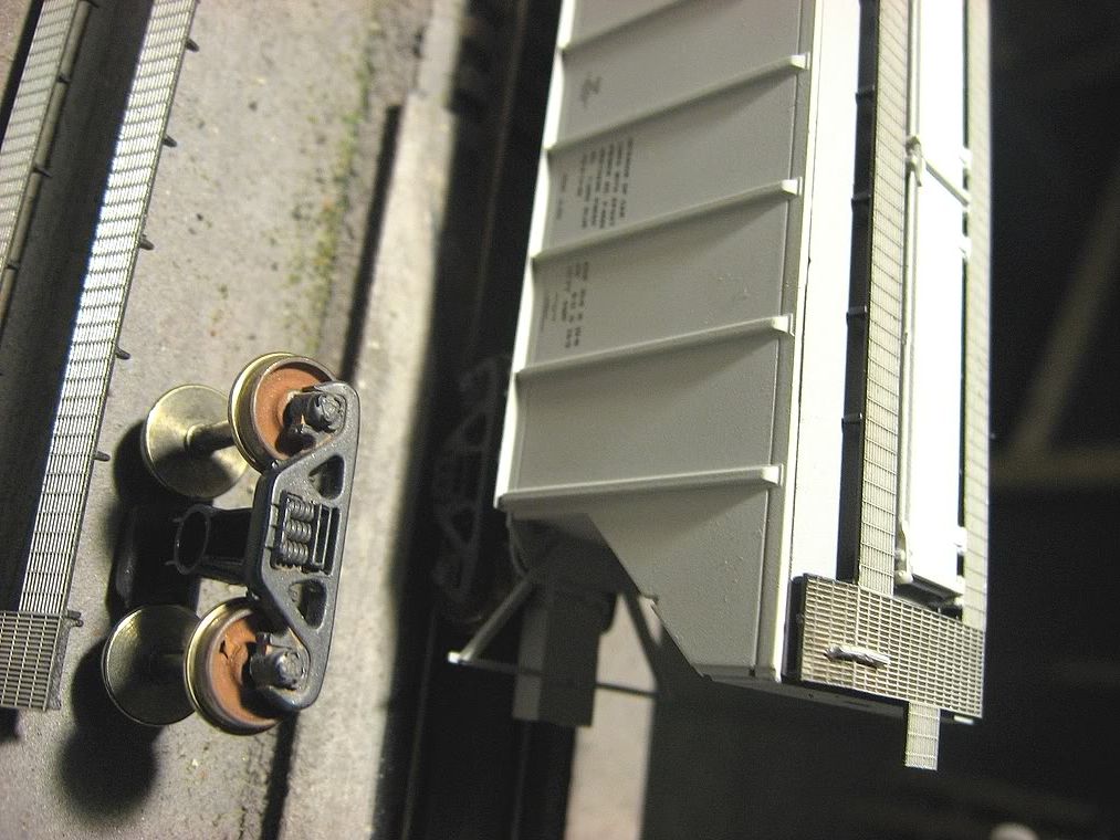

These are not Athrean, but Lifelike covered hoppers. I assume the walkways are produced in a similar way.
These got a coat of flat black spray paint underneath.
For the top; First I spray the walkways with dullcote. After that is all dry I coat the surface with rubbing alcohol, then brush on a black wash of 50/50 water and acryllic. Sometimes I dab on a little rust colored wash before it all drys.
Anybody notice my foul up on this one?

Here’s a different technique
For covered hopper walkways, one technique is to try and highlight the high spots of the mold walkway. As others said use a balck wash or paint the walkway blakc and wipe off the excess. Then weather lightly with rust etc. Another option is to replace them with etch metal walkways. An excellent upgrade that gives the see through look need for a light, open walkway.
